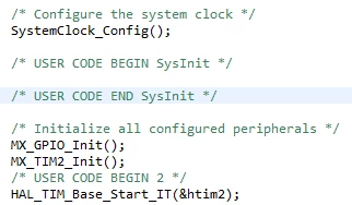

STM32G4 Interrupt not working. The program always run default handler.
The code is generated by CubeMX. And every time program run into HAL_TIM_Base_Start_IT() like the figure below, the system will block in Default Handler. 0693W00000YALAhQAP.pngHowever, the TIM2_IRQHandler is defined in stm32g4xx_it.c.
0693W00000YALBaQAP.pngDoes anyone have idea why it doesn't work? I also attach the code.

Code looks OK.
Check if the user FLASH is mapped to 0x00000000; in other words, check, if you don't boot into the default bootloader in System Memory.
Also check SCB_ICSR.VECTACTIVE value.

KnarfB
February 9, 2023
Your project works on my B-G431B-ESC1, tim_ticker incrementing as expected. STM32CubeIDE asked for migrating to the latest revision, what I did.

FCHEN.2
FCHEN.2Author
February 10, 2023
Thanks! The problem is the boot mode. When I set boot from System memory, the program works well.
