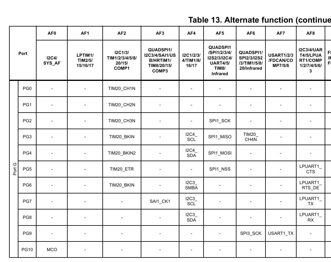

I'm using CubeIDE and I have PG10 configured as MCO output and I see nothing. Usually when I see this, there is a HAL enable command I missed, but I don't think there is in this case.
I've tried multiple clock sources and the pin stays at voltage high. I've checked on all the registers I know:
GPIOG
   MODER -> MODER10 = 0x2 (alternate function)
   AFRL = 0x0
   AFRH = 0x0
I suspect that having no alternate function set in AFR\L registers is what is not correctly set, but I don't see the mapping table mentioned in the reference manual:  "Refer to the “Alternate function mapping” table in the device datasheet for the detailed mapping of the alternate function I/O pins."
What should these registers be set to for MCO and where is the mapping table?
Best answer by KHarb.1
PG10 is also the NRST pin. I was able to trace this behavior to the NRST_MODE bits in FLASH_OPTR. I changed them from 0x3 to 0x2 and the MCO output started working along with normal GPIO which I also found to be failing.
So did you? The datasheet is a separate document from the reference manual.
MCO is AF0, so 0 is correct in those registers.
Make sure output speed is very high.

Ahh...once again, datasheet and reference manual are different.  So, yes...AF0 is correct.
