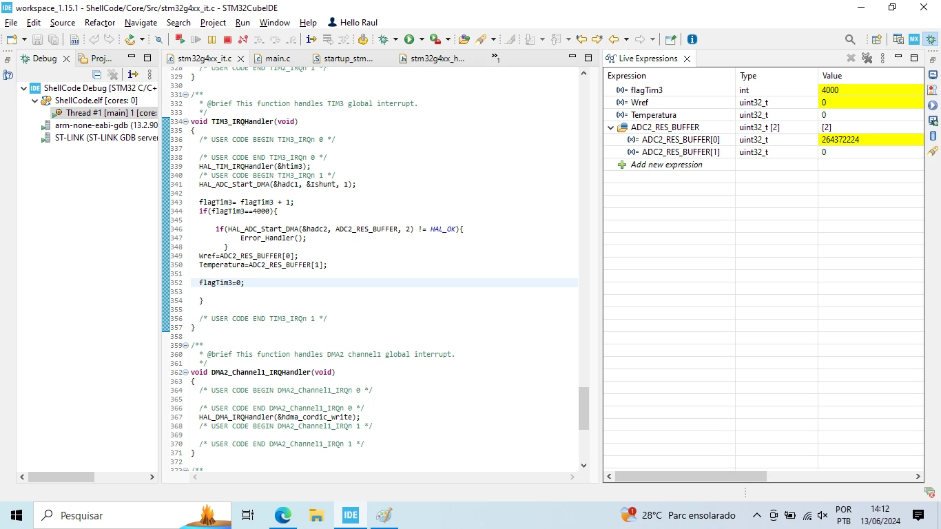

STM32G4 ADC MULTICHANNEL DMA
I'm trying to read ADC2 IN1(PA0 connected to GND) and ADC2 IN2 (PA1 connected to 3.3V).

You need to describe the problem. Sharing a photo cannot give much clear image on what is going on...

I was expecting you to describe the problem because when i'm trying to read a single channel using this method it works perfectly but after the IN2 was added the conversion does not succeed. Since PA0 is connected to GND the ADC2_RES_BUFFER[0] should be 0 or near it, but as you can see on the screenshot it shows a value near to 264x10^6. And as you can see if the Conversion != OK the code gets stuck in the first conversion, the ADC2_RES_BUFFER[1] does not have his value update and the code does not get to clearing the flagTim3 variable.
If you could please tell me more about the details you need to help me solve this. Thank you for your answer and time.

I'v solved this issue by changing the variable ADC2_RES_BUFFER[2] to uint16_t. Worked perfectly.
