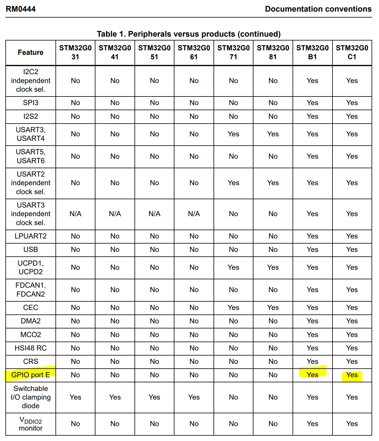

STM32G0x1 external interrupt from PE possible?
My target device is a STM32G0B1VE which has PE but according to RM0444 Reference manual for STM32G0x1 chips the description of EXTI_EXTICRx register says that combination for PE is not present (reserved). Is it really no possible to use PE for an external interrupt? I don't have hardware yet so I cannot test it.

I confirm that Port E is set to enter the EXTI, and the RM should be fixed.
Thank you for your contribution and spotting this out.

Probably the RM was written when there weren't any chips with a GPIOE and wasn't fully updated. I would be surprised if it didn't work. I don't have a chip to test.

I have the same opinion, STM32G0B1 and STM32G0C1 are the latest devices from the line. Also older IDEs doesn't support them so I suppose the RM is probably outdated in this way.
