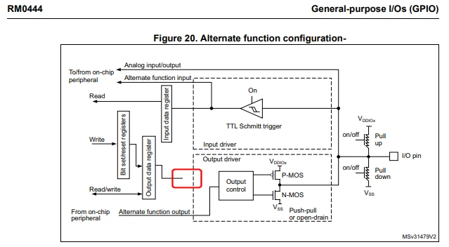

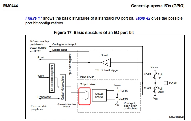

Can I control the level of a GPIO Pin in software, if the GPIO Pin is in an Alternative function mode ?
For example, I have an application where I switch a MOSFET in Software, but I would like to use the Hardware or internal Silicon, and Software to turn the Pin on and Off, is this possible with the STM32G031 controllers ?.

@danielbathtub - you can see this in Figure 17  in the Reference Manual:
The multiplexer connects either the Output Data Register (ODR) or the Alternate Function (AF) to the output driver.
Figure 20 shows the case when the output is configured as AF:
Note that the ODR is disconnected from the output driver - only the AF is connected.
So your software writing to the ODR in this case will have no effect.

Either you or a peripheral control the level. If you need to take control, remove it from the peripheral (AF)
If you want to drive a pattern against a port bank, you can DMA into GPIO->BSRR
