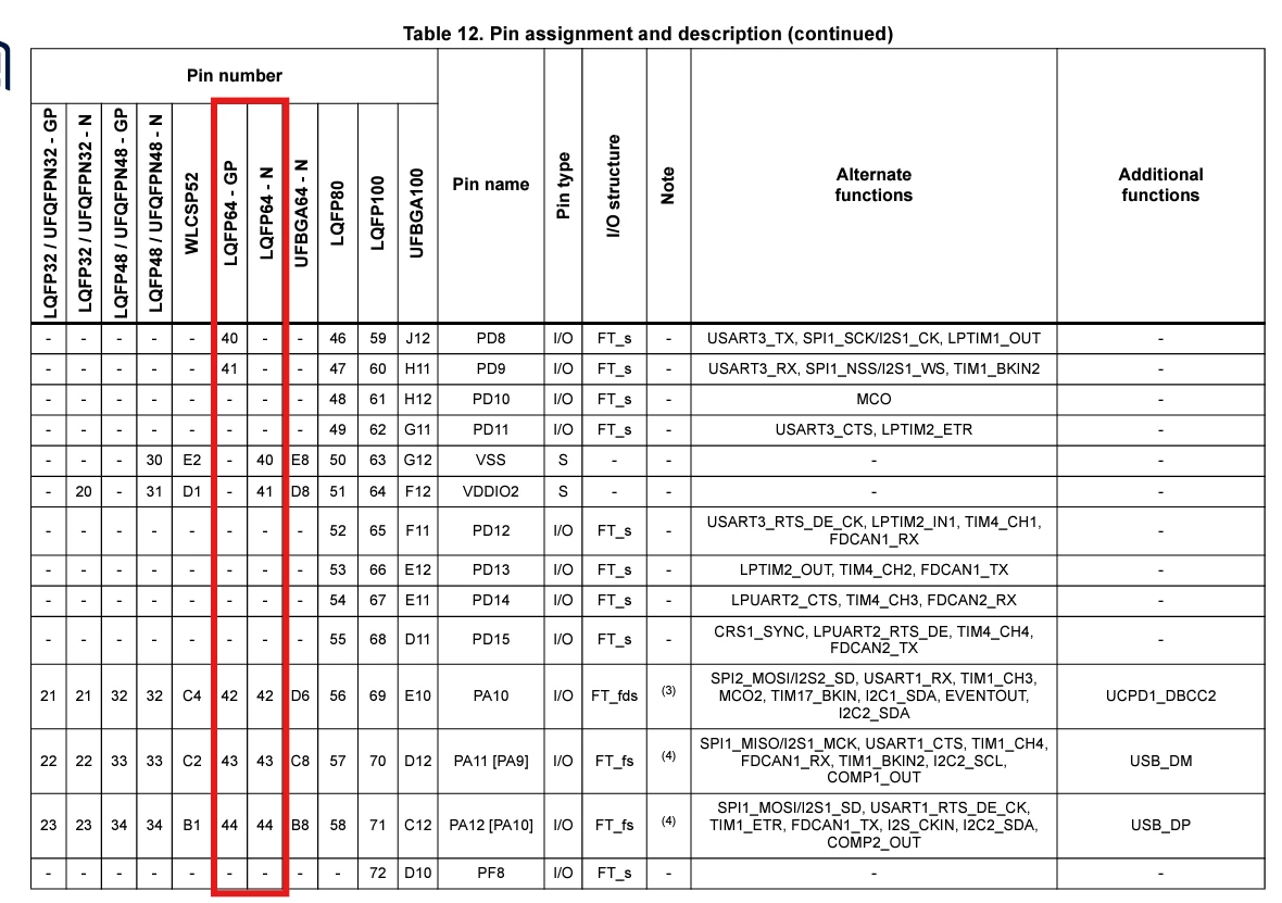

two type of pin descriptions have mentioned in the datasheet, I confused which one I have to take for "STM32G0C1RET6" this part and which pin I will for watchdog timer so kindly help me. Find the screenshot for your reference.

This is explained in section 4 of the data sheet:
The devices housed in 32-pin, 48-pin, and 64-pin packages come in two variants - “GP” and “N” (the latter with ordering code having N behind the temperature range digit).
Hope that answers your question?
