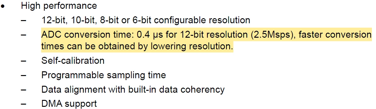

Im not sure i fully grasp yopur needs, but what about DMA+ADC, using timer base without interruption? disabling DMA interruption aswell?, just thinkign outloud here.
The ADCs are supposed to be able to manage up to 64Mhz.
Did you already tried something?
The adc can be run faster but the sampling time still has its limits.

@Carl_G wrote:
Interesting, giving the fact I only need to know if the current clock pulse value is either a logic 1 or a 0, I don't mind truncating the resolution at all, 6 bits is more than enough, but it still seems I'm using a bit much.
Can't GPIO support 16MHz access to the input of the pin and just configure a timer with the frequency of the reference 16 MHz clock to generate a gpio read on each rising edge event?
