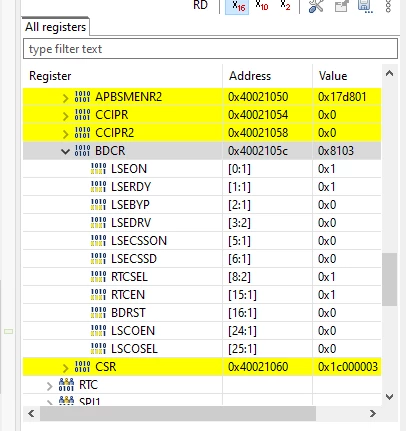

GEORGE SANDLER
Mar 24, 2025 9:11 PM UTC
This is the BDCR register when PA2 is acting as a clock output.
waclawek.jan
Mar 25, 2025 10:47 AM UTC
OK so LSCOEN is 0, which appears to indicate that the problem may have some other root than LSCO being active.
What makes you to say that PA2 is "acting as a clock output"?
What signal do you observe at PA2 and how do you observe it?
What hardware do you use, what is connected to PA2?
Read out and check/post content of GPIOA registers, for both "good" and "bad" states.
