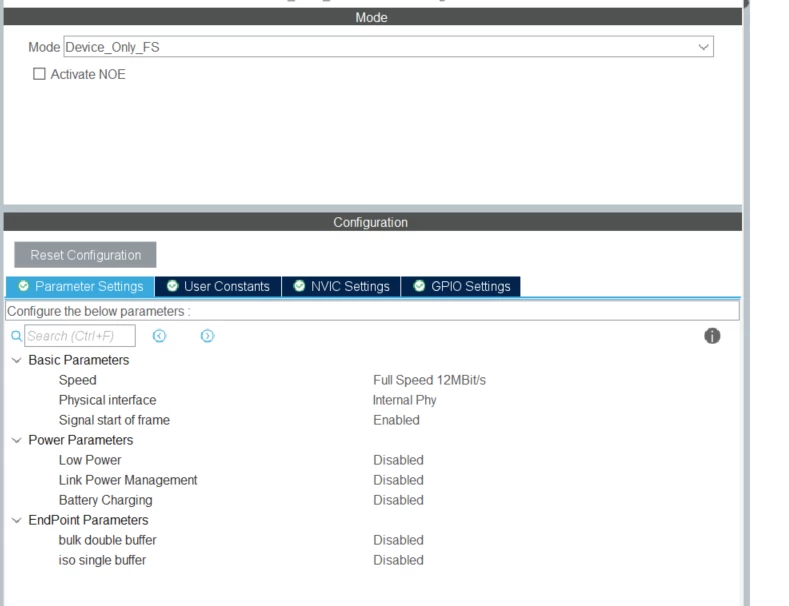

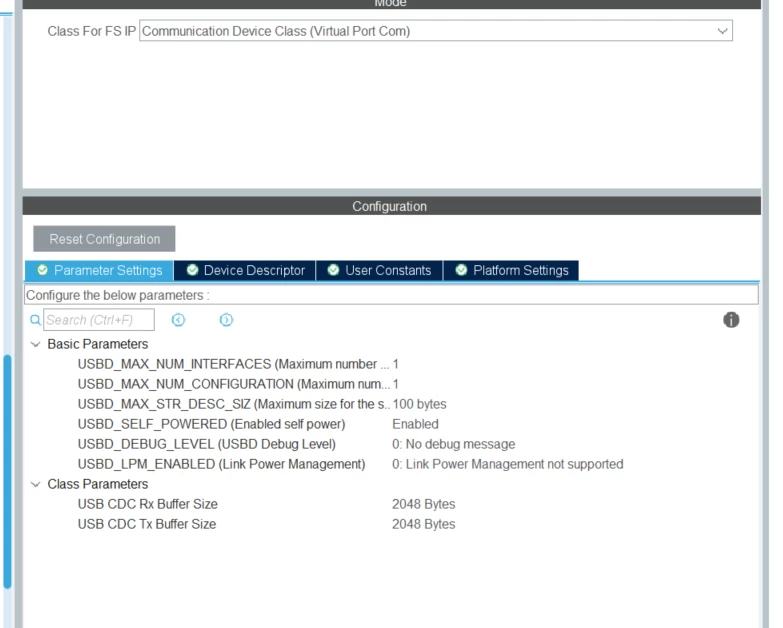

Hi, I am using STM32G0B1KC ad usb device. I will show you all the conficuration for USB_DRD_FS and USB_DEVICE middleware.
I am using the internal HSI48 for the USB clock.
When I connect the device to my PC, the device is not recognized.
Can anyone help me?

Hi, I solved the issue. It was an hardware problem. During soldering, D+ and D- were shorted. Thank you

Have you selected the USB middleware class to be imported? ST classic middleware or USBX ?
