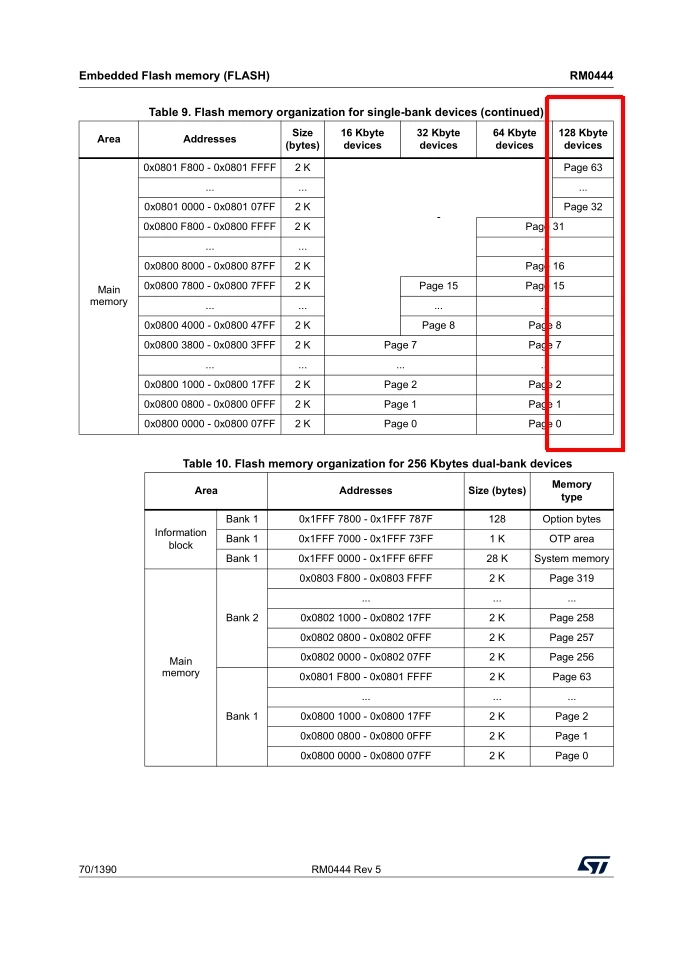

STM32G0B1KBT6 flash module organization
Hi good day, could you guys please tell me where i can get the STM32G0B1KBT6 flash module organization Table? i've looked for it on datasheet but found nothing

You can see the document number at the top and bottom of that screenshot. Also look at there:
https://www.st.com/en/microcontrollers-microprocessors/stm32g0b1kb.html#documentation

0693W00000aHCrFQAW.pngJW
fasyr.1
fasyr.1Author
February 21, 2023
where did you get it? i've tried look for it on the whole datasheet but didnt found it
