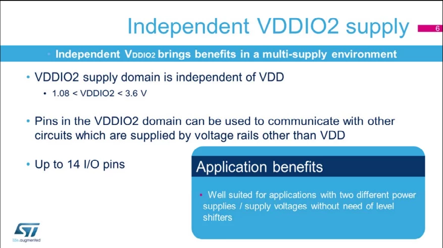

Thanks for your reply. Based on your answer, I searched a bit more and found this:
It seems that it is not only for USB, but also for different peripherals. It is convenient for environments with different bus voltages. In my case (LQFP-48), I have main voltage level of 3.3V. I can now set VDDIO2 to 1.8V and work directly with the modem without using a level shifter.
