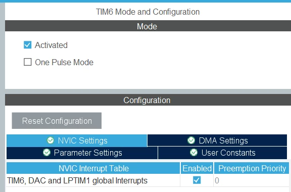

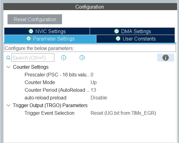

My settings for Timer 6 are as follows:

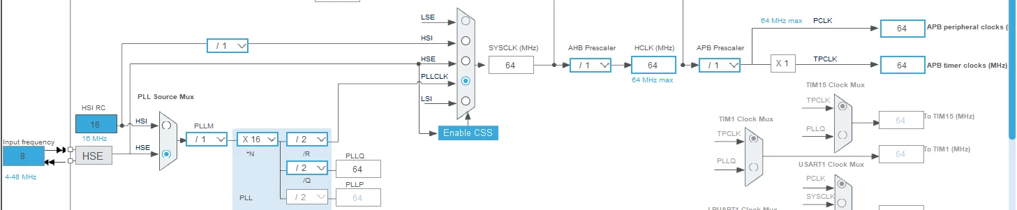

My clock configuration is as given below:

htim6.Init.Prescaler = 0;
htim6.Init.CounterMode = TIM_COUNTERMODE_UP;
htim6.Init.Period = 13;
htim6.Init.AutoReloadPreload = TIM_AUTORELOAD_PRELOAD_DISABLE;

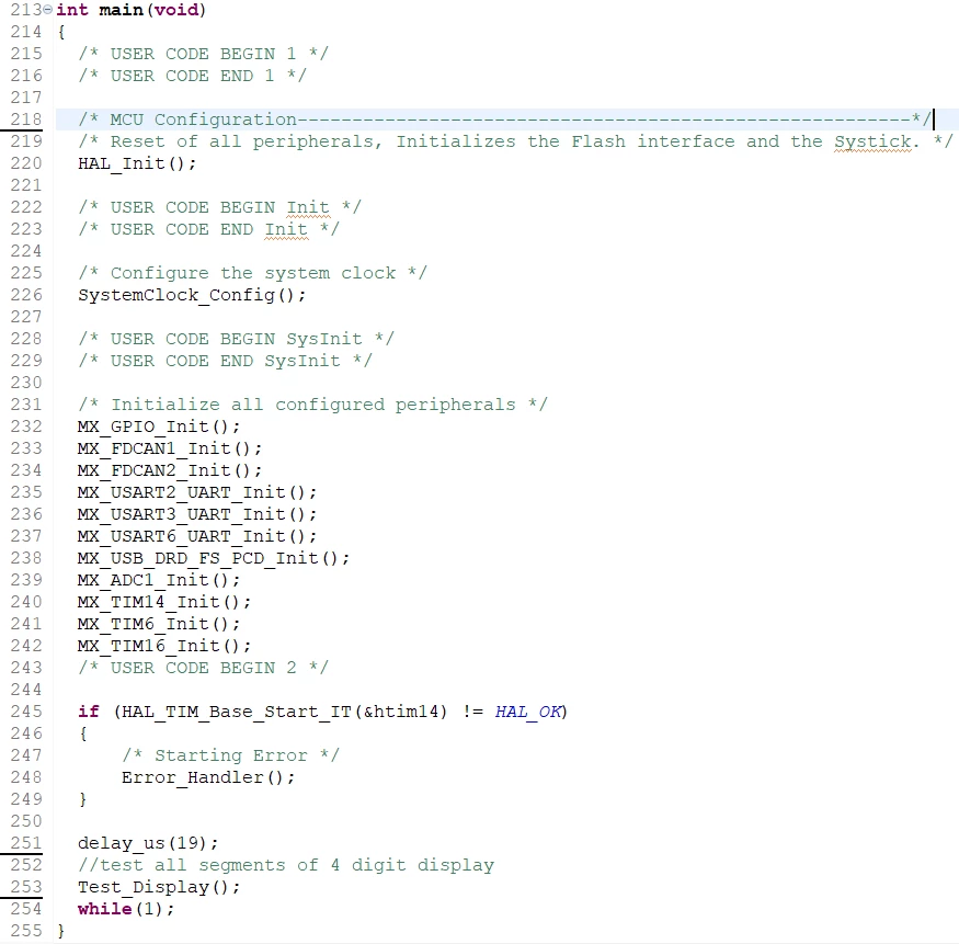

After putting while(1); in the code, observations remains same i.e. debug cursor gets lost in delay_us() function.  Hitting "pause" icon lead to stop somewhere in interrupt service handlers. Every time in different handlers and at different statements of code which is auto generated by tool.
I also tried following but behavior remains same
1. using timer16 instead of timer 6.
2. merging code of delay_us() function directly in main() function
3. Increasing minimum stack size from 0x400 to 0x800
4. Replacing Test_Display() function by another code which writes to GPIO pin
But if I use HAL_Delay(1)  function then it works. But 1ms delay is too much for my application.
Please suggest.

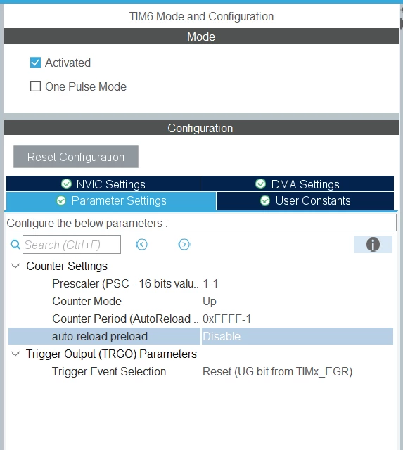

Mar 6, 2025 11:51 AM UTC
I referred following video:
https://www.youtube.com/watch?v=SqC0IhLKJ9o
I did modifications as explained in this video which resolved my issue.
delay function is updated as below:
void delay_us(uint16_t delay)
__HAL_TIM_SET_COUNTER(&htim6,0);
while(__HAL_TIM_GET_COUNTER(&htim6) < delay);
In main function, timer 6 was started.
HAL_TIM_Base_Start(&htim6);
Timer configuration was done as below:
