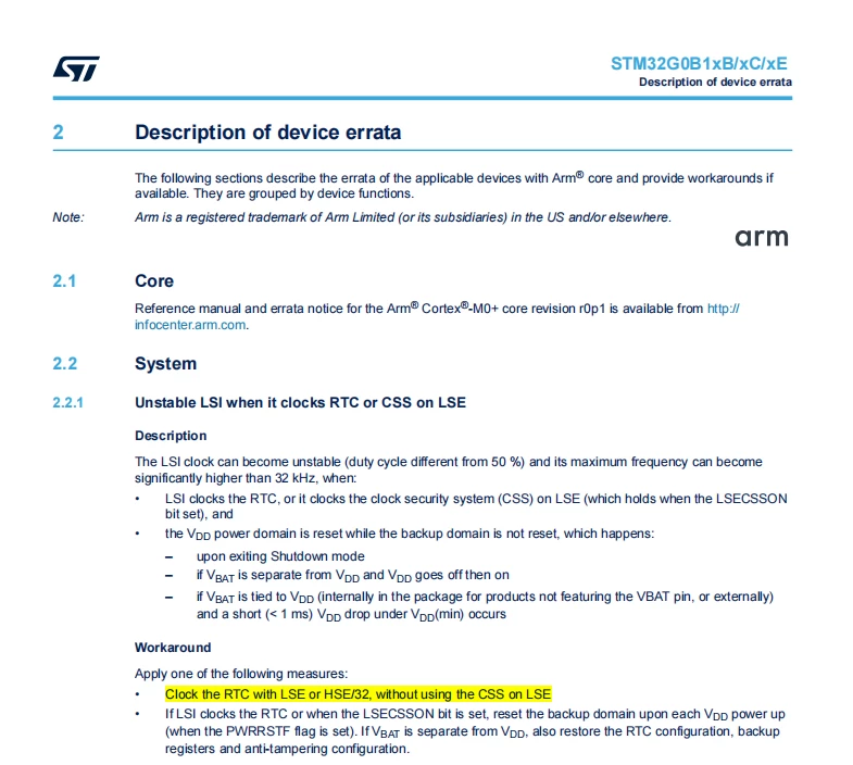

It's not certain whether this is caused by this defect, but it is indeed mentioned in the errata manual.
3 replies

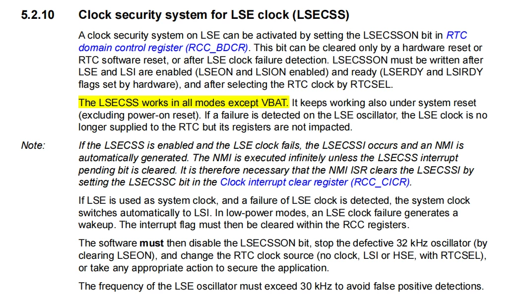

Is the LSECSS detected after the power supply of the backup domain is switched from VDD to VBAT?
SunwazAuthor
January 21, 2025
One solution that comes to my mind is to enable the PVD and disable the LSE CSS function within the PVD. Then this problem can be avoided.
