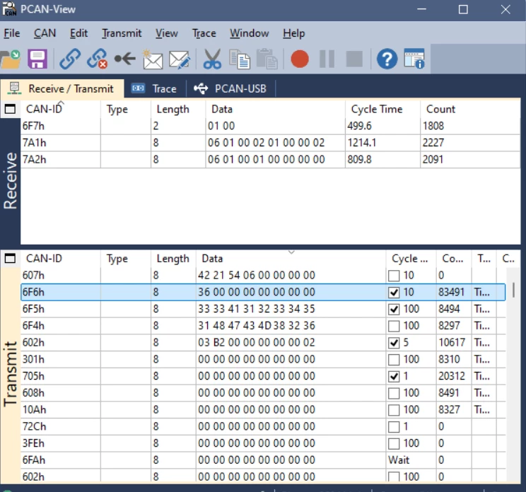

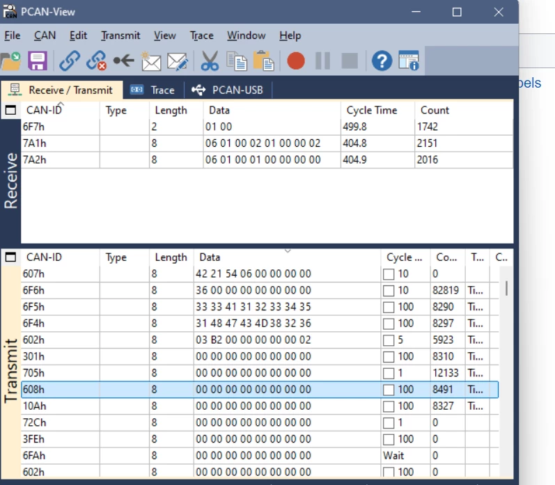

I am using STM32G0B1,  i have implemented the FDCAN communication but the issue i am facing with the cycle time
i have set the cycle time for 500ms i.e. every 400ms CAN messages will be transmitted.
every thing works good until i am not receiving the CAN message in my callback function but when i send the CAN messages the cycle time for message increases to 1000ms 1500ms and come back to 400ms this happens often.
cycle time when not receiving CAN message (refer below image ID 7A1, 7A2)
cycle time when receiving CAN message (refer below image ID 7A1, 7A2)

@bhupender-singh wrote:
case 1:
When i am sending message only and not receiving and message cycle time is constant
case 1:
When i am sending message and receiving and message at same time the cycle time is fluctuate.
This is what I have a doubt about.
This is a normal behavior. The callback is a code executed in an interrupt context and this delays the execution of the transmit in main(). So you need to simplify your code in the Callback keep just the buffer receive and all the treatment needs to be moved to the main. The interrupt code needs to be as light as possible.
For transmit try to use a Timer and send frames from the interrupt (same case: code needs to be as light as possible).
