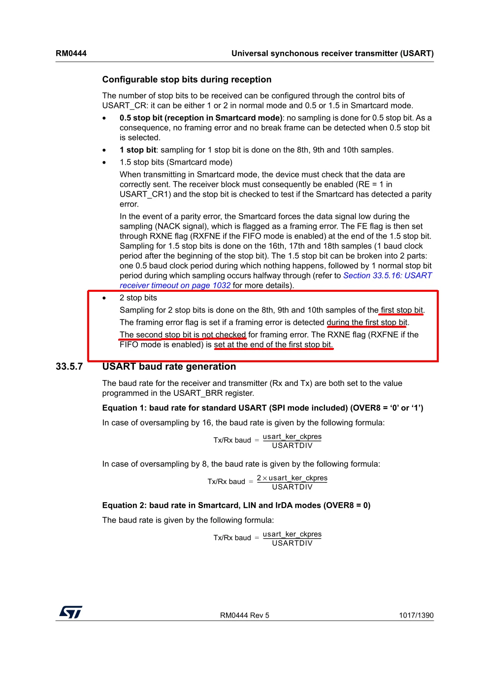

I don't know. But number of stop bits are a setting of the transmitter, while the problem is in the receiver, so I'd say, the number of stopbits in the receiver does not change the behaviour.
In other words, if the glitch happens in the second half of 1st stopbit, the problem occurs; if later, the problem won't occur.

waclawek.jan
June 7, 2024
> the number of bits in the communications protocol must be matched on the sender and receiver sides for communication to be established
No.
This basically says, that the 2nd stop bit is entirely ignored in the receiver.
matsuamiAuthor
June 11, 2024
Hello waclawek.jan
Thank you for providing the excerpt from the reference manual.
I could understand that in 2 stop bit mode, if there is no error in the first BIT, then readable normal data is written to the FIFO at that point.
So, even if there is a glitch in the second BIT, it is impossible for corrupted data to be written to the data register.
You're a real guru. Thank you.
