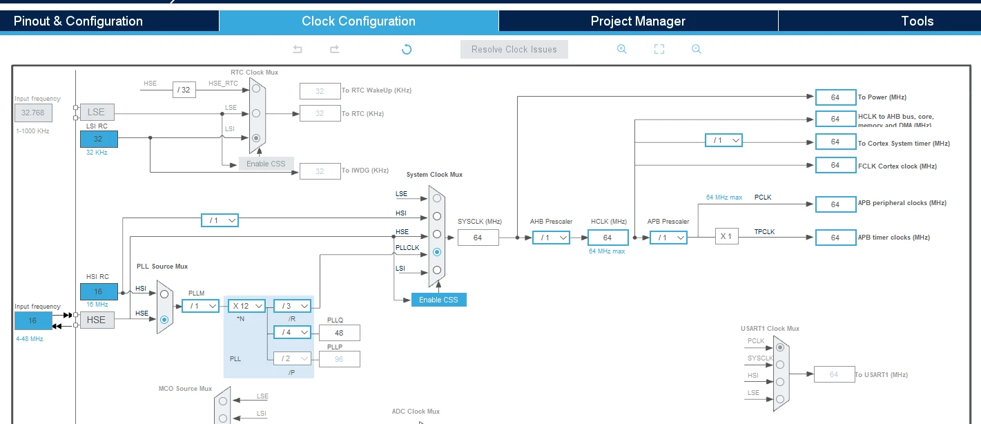

hello.
Using STM32G0B0CET6
USB_DRD_FS---Host_Only_FS,
USB_HOST---Mass Storage Host Class,
FATFS---USB Disk
USB Interrupt---Enable
If you set it to the above mode and operate it, the USB is recognized only once when the power is first turned on, and the USB Mount/Unmount function does not work at all from then on.
It seems that the interrupter is activated only at the beginning of power-on and is disabled thereafter.
It works fine with stm32f401 with same configuration. What causes it?
I ask for help from experts.

Hi @Kimjunho
Which clock is selected for host configuration? Could you share your software setup? your hardware configuraiton?

March 6, 2024
The USB clock is 48 MHz with an external crystal oscillator of 16 MHz.
It is recognized only once when the initial power is turned on, and the USB interrupter does not operate from then on.clock_config.png
