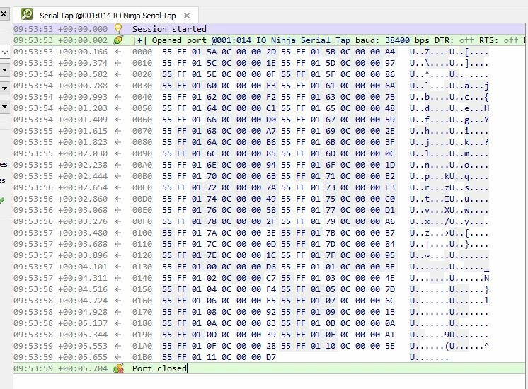

485:        55 FF 01 11 0C 00 00 DC

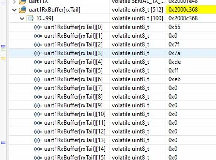

USART:  55 00 7F 7A DE FF EB 00

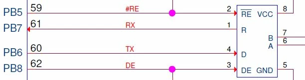

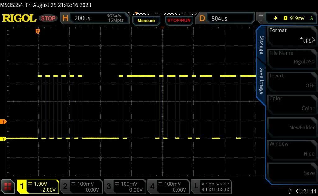

Notes: All the 485 packets seem to be 8 bytes in length and the micro received packets can be seven or 8 bytes. The scope trace is taken going into the micro after the 485 chip(THVD1410DR). The scope trace seems to show the second byte as all ones.

		uart1RxBuffer[rxHead][uart1RX[rxHead].rxSize]	= LL_USART_ReceiveData8(USART1);
		uart1RX[rxHead].rxTime[uart1RX[rxHead].rxSize]	= timer3_get_count();
		uart1RX[rxHead].rxSize++;

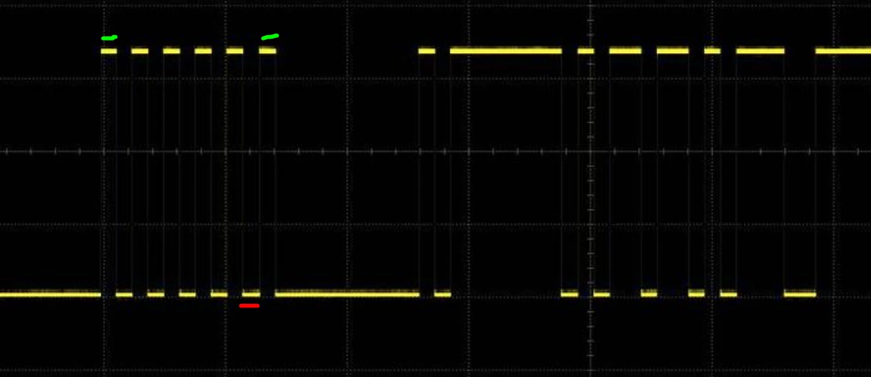

UART is typically idle high. Is yours idle low and if so is RXINV set?
Seems like 0x55 0x00 is plausible for the first 2 bytes to me. Start bits in green, stop bits red.

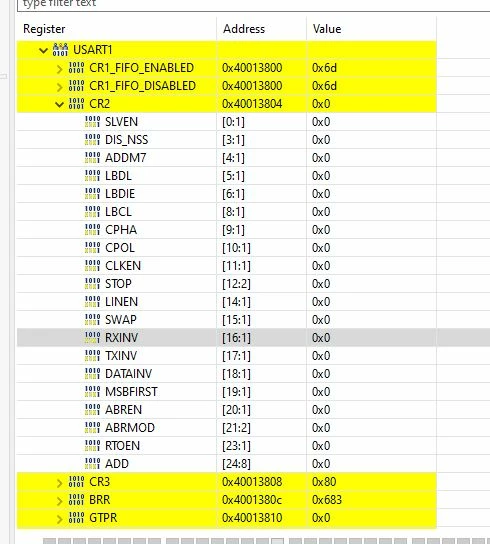

Hmmm, seems like RXINV is off. Not really sure how the RS485 chips takes the twisted pair data and converts it. I'll look at the data sheet. Just seemed weird that the first byte was fine but the second was inverted.

You may have swapped A and B Unfortunately, there's no standard for this, and in some environments (e.g.Modbus) the marking is opposite to what the IC manufacturers use.
