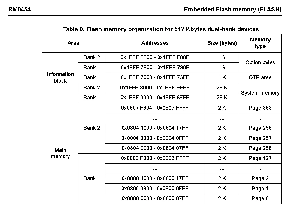

I work on STM32G0B0. This picture is correct from reference manual?
For BANK1 appears to be correct, but for BANK2, numbering starts from 256 to 383 which I guess id wrong. Shall be 128...255.

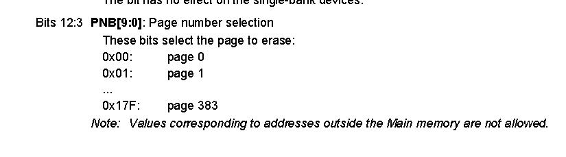

_legacyfs_online_stmicro_images_0693W00000bjiN7QAI.pngAsking because also FLAHSH->CR, PNB appears to be wrong too.

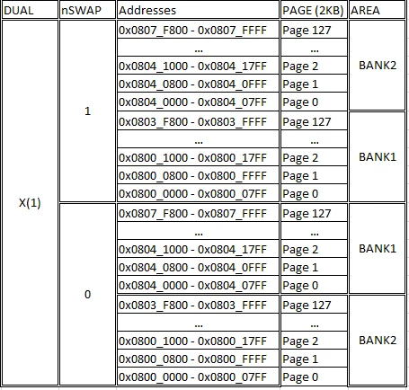

Dear @yo3hcv​,
This table below reflects how page number works on G0 dual/single bank capability as it depends of nSWAP_BANK option bit.
_legacyfs_online_stmicro_images_0693W00000bjsMnQAI.pngFollowing this table, make sure your software is aligned. Here below an example to erase a page located into the Bank2, two points are mandatory:
  • Set a page number within PNB range (0-127)
  • Set the BKER bit to select the Bank2

Hi @yo3hcv​ ,
Yes we have noticed this issue on the documentation both banks are in series, so for the 512K :
BANK1 : page 0 to 127
BANK2 : page 128 to 256
This should be fixed on the new version of the reference manual.
Thanks again for you contribution ;).

Not quite accurate, nSWAP has nothing to do with layout, however, your pages numbering are correct.

  • use PNB as 0..127, any other value will wrap around and erase in the same area !!!
  • PNB is implemented as 7 bits only (mask 7F not 17F like in RM) !!!

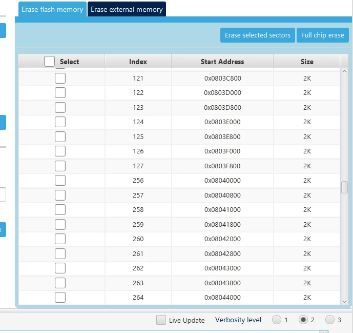

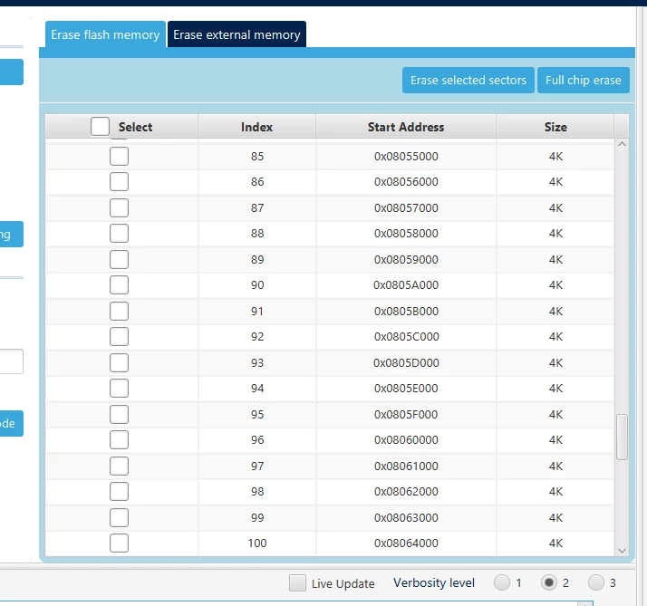

Also please fix the STCube Programmer too 
If you de-select DUAL_BANK will show 4k sectors which is wrong
_legacyfs_online_stmicro_images_0693W00000bk0JcQAI.pngFor DUAL_BANK will show correct 2k sectors, but with the same crap numbering, jumping to 256 ???

You are right. nSWAP_BANK is available on STM32Gx1 Series and not on Value line STM32G0B0.
Moreover, PNB is indeed 7-bit wide and will be updated in next RM revision of RM0444 & RM0454.
To be more precise, PNB register is common to both memory cut while BKER bit is impacted by nSWAP_BANK and DUAL_BANK bit (for STM32G0x1 devices only).
BKER = 0 ==> BANK mapped at 0x0800_0000 is selected
BKER = 1 ==> The other BANK is selected
