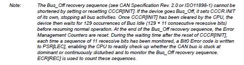

As stated by @MHoll.2, the conditions to recover from Bus-off are described in the reference manual.
In fact to recover from bus off state you need to do it by software:
Example:
Activate Bus-Off interrupt:
HAL_FDCAN_ActivateNotification(&hfdcan1, FDCAN_IT_BUS_OFF, 0);
In the call back, recover from bus-off state by software:
void HAL_FDCAN_ErrorStatusCallback(FDCAN_HandleTypeDef *hfdcan, uint32_t ErrorStatusITs)
 if((ErrorStatusITs & FDCAN_IE_BOE) != 0) /* If Bus-Off error occured */
 hfdcan->Instance->CCCR &= ~FDCAN_CCCR_INIT; /* Recover from Bus-Off */
