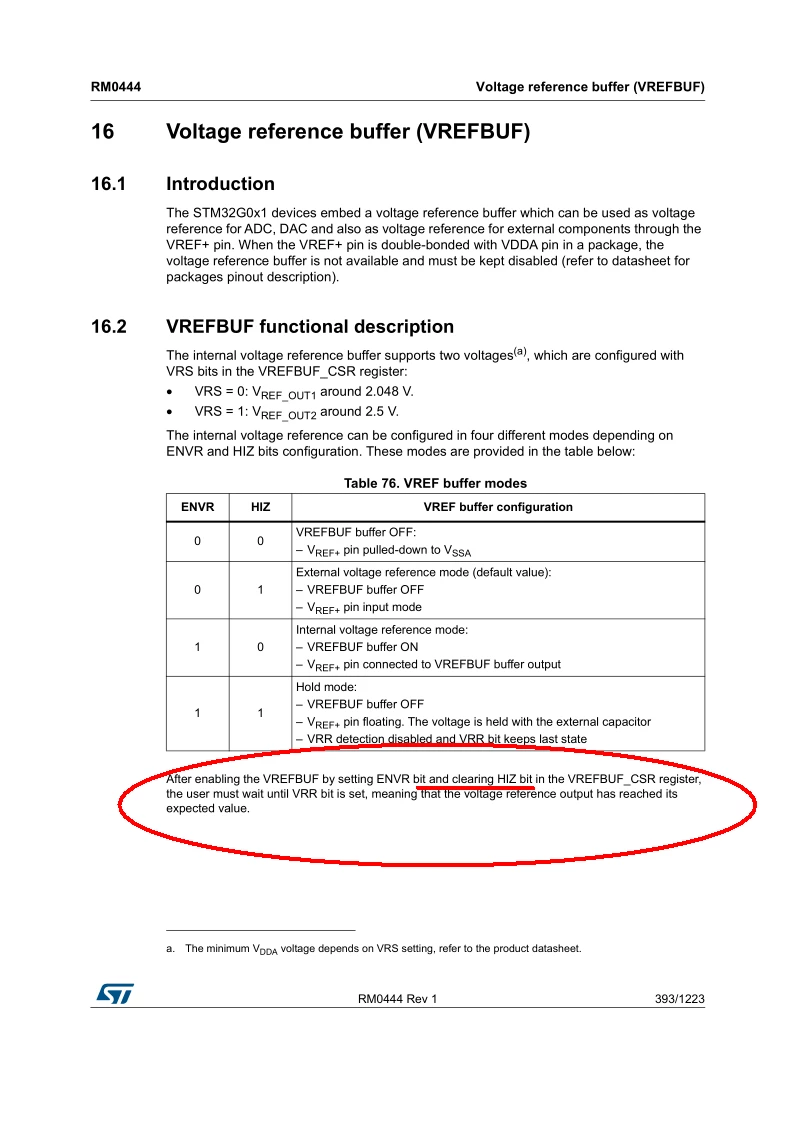

Hi Jan,
in this case VRR should go high after settling, but it stays low for ever? Here is the code:
VREFBUF->CSR = 0x000000003;   // ...00000011 VRS=0, HIZ=1, ENVR=1 => VREF = 2.048V
while ((VREFBUF->CSR & 0x00000008) == 0);      // Wait until VRR = 1 => VREF Buffer ready
If I use the default setting and VREF+ pin (5) = VDDA = 3.3V all works correctly if I do not wait for VRR.
VREFBUF->CSR = 0x000000006;   // ...00000110 VRS=1, HIZ=1, ENVR=0 => VREF = VREF+PIN
But the internal 2.048V or 2.500V VREF Buffer does not work at all?

waclawek.jan
November 10, 2019
Did you read back the value from VREFBUF->CSR in debugger or otherwise, and check the bits you've set/cleared?
Do you have clock enabled in RCC_APBENR2.SYSCFGEN?

November 11, 2019
The SYSCFG reset bit must be cleared in RCC APBRSTR2, it is active as long as set.
"If I comment the while loop the ADC works fine but its values refers to the 3.3V voltage applied to VREF+Pin and not to the internal 2.048V or 2.500V."
You confirm that no supply is connected on VREF+ when trying to switch ON the buffer? Just the capacitance?
Regards,
Antoine

November 11, 2019
​Hello,
Just tried with those 4 lines and it worked fine on my side.
But on QFP64...
  RCC->APBRSTR2 = 0x00000000;
  RCC->APBENR2 |= 0x00000001;
  VREFBUF->CSR |= 0x00000001; // ...00000001 VRS=0, HIZ=0, ENVR=1 => VREF, VREF+Pin = 2.048V
  VREFBUF->CSR &= ~0x00000002;
