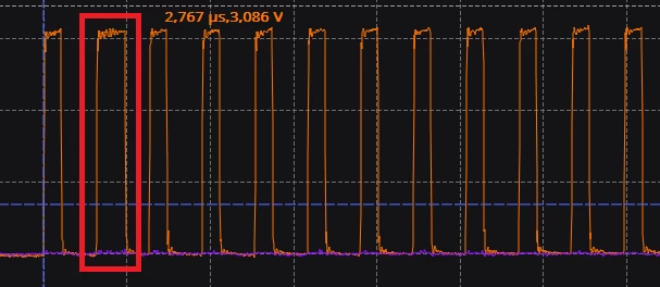

I'm trying to talk to WS2812 RGB Leds. I'm using TIM1 CH3 PWM Output with DMA. Everything looks almost fine. I'm always sending the same data using:
HAL_TIM_PWM_Start_DMA (&htim1, TIM_CHANNEL_3, (uint32_t *) pwmData, (24 * NUM_OF_LEDS) + 50);
Here pwmData sets a duty cycle of 33 % (20 of period 60, 48 MHz) for the first 13 cycles. In between I wait for 500 ms.
But time to time (~1 out of 3) the second pulse behaves strange. Only the second pulse seems to randomly jump approx. from duty cycle 20 ... 80 %. All remaining pulses are correct.
Thanks for any hint!

I don't use Cube and don't know how exactly Cube does this thing, but under certain circumstances (CCR preload enabled), the first two pulses may actually be result of the last two values in buffer from the previous run.
Try using deliberately different duty cycles in the first few cycles, like 30% in first, 40% in second etc., and observe.

I'm a little late, but maybe I can help someone with the same issue.
I solved that problem by adding two zeros before the data. You need to declare:
uint16_t pwmData[24*NUM_OF_LEDS + 52]
Then, before adding the data, you need to do this:
pwmData[0] = 0;
pwmData[1] = 0;
For some reason, the second data sent from DMA to PWM gets glitched. Sending two null values before the data solves that problem.
