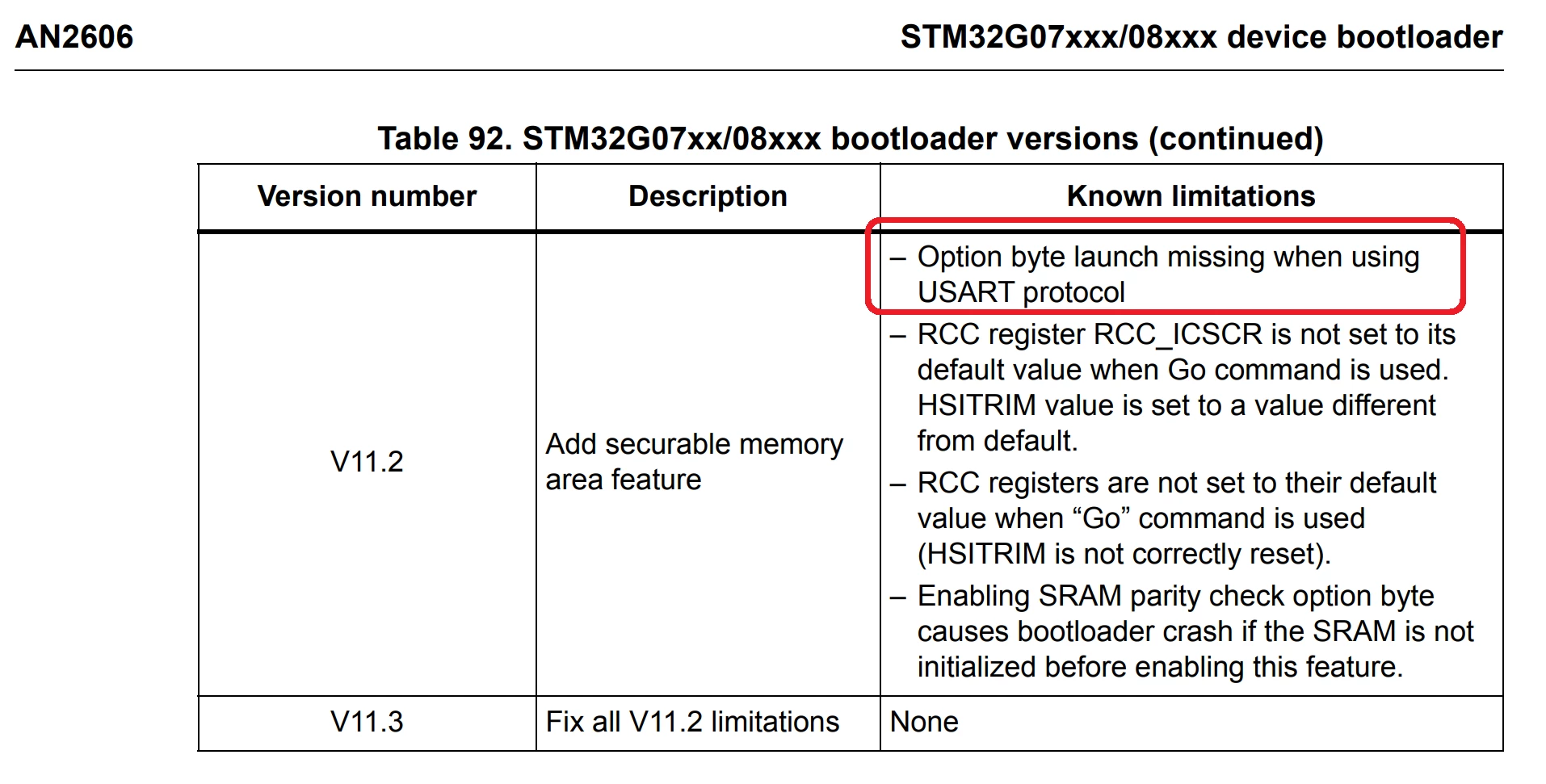

I'm trying to exit the STM32G07 USART bootloader by setting the nBoot0 bit in the Flash Option register.
I noticed in AN2606 in Table 92 that V11.2 of the STM32G07 bootloader shows the following issue: "Option byte launch missing when using USART protocol".
Do you have more information about this issue?
Could this be the reason that setting the nBoot0 bit via the USART on the STM32G03 exits the bootloader as expected, but setting the nBoot0 bit via the USART on the STM32G07 does not exit the bootloader?

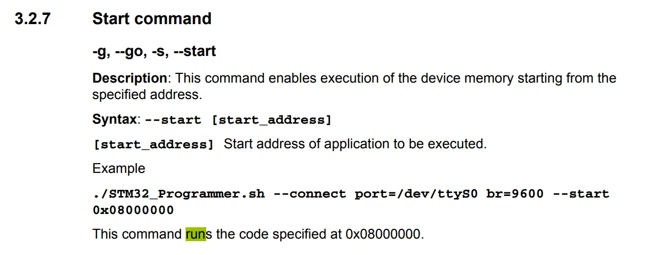

MM..1
Chief III
October 4, 2023
Maybe your steps isnt optimal. Why you dont use run command . This provide start application ability better.
In gui on CPU panel if i rememmber or
