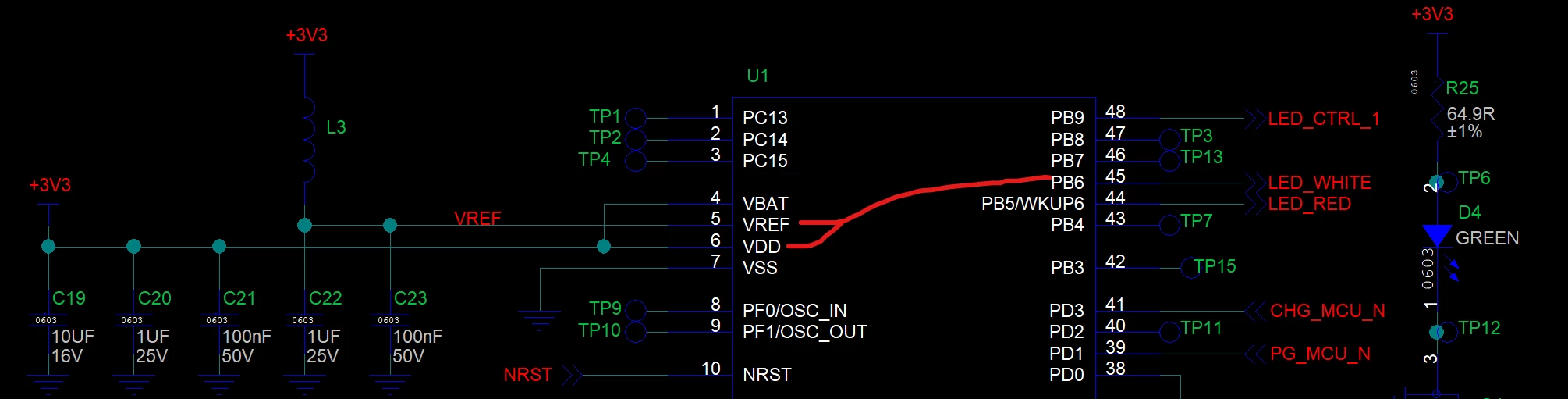

I have made up six boards and three of them had an unusually high standby current (35mA instead of 1mA).
Eventually, when the IC was removed, we found Pins 5 & 6 of the removed IC were shorted internally (0.3R)
They were also shorted to pin 45 with 3.7R. The other two boards are showing similar shorts.
The board worked fine with a new MCU.
Does anyone know what might cause this short?
TIA,
Patrick.

> STM32G070CB76
Not a chip. Probably STM32G070CBT6?
Pins shorted indicates hardware damage. Probably due to overvoltage at one point. Does L3 cause VREF+ to spike at powerup? What is attached to LED_WHITE?

Thanks, typo in chip code corrected to STM32G070CBT6.
LED_WHITE connects through a resistor to a led.
VREF+.. I don't know - some kind of intermittent event? These are the second batch of boards - the first 10 had no issues with hundreds/thousands of power-ups.
Could ESD be an issue?

Jul 16, 2025 3:55 PM UTC
Yep, it could be ESD.
