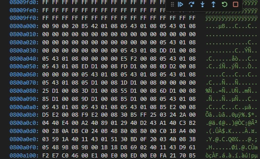

So I changed the app address and the code:
// build_flags = -DUSER_APP_ADDRESS=0x0800A000
void BootJump(void) {
 void (*Jump)(void);
 HAL_RCC_DeInit();
 HAL_DeInit();
 SysTick->CTRL = 0;
 SysTick->LOAD = 0;
 SysTick->VAL = 0;
 Jump = (void (*)(void)) (*((__IO uint32_t *)(USER_APP_ADDRESS+4)));
 SCB->VTOR = (uint32_t)USER_APP_ADDRESS;
 __set_MSP(*(__IO uint32_t*)USER_APP_ADDRESS);
 Jump();
App linker changed to:
/* Memories definition */
MEMORY
 RAM (xrw) : ORIGIN = 0x20000000, LENGTH = LD_MAX_DATA_SIZE
 FLASH (rx) : ORIGIN = 0x800A000, LENGTH = LD_MAX_SIZE - 0xA000 - 2048
App build flags:
-DVECT_TAB_BASE_ADDRESS=0x08000000
-DVECT_TAB_OFFSET=0xA000
The app seems to be correct in flash.
After the jump, the PC is stuck at 0x08014304
Looks like it has crashed, but platformio does not show the disassembly for this section.
