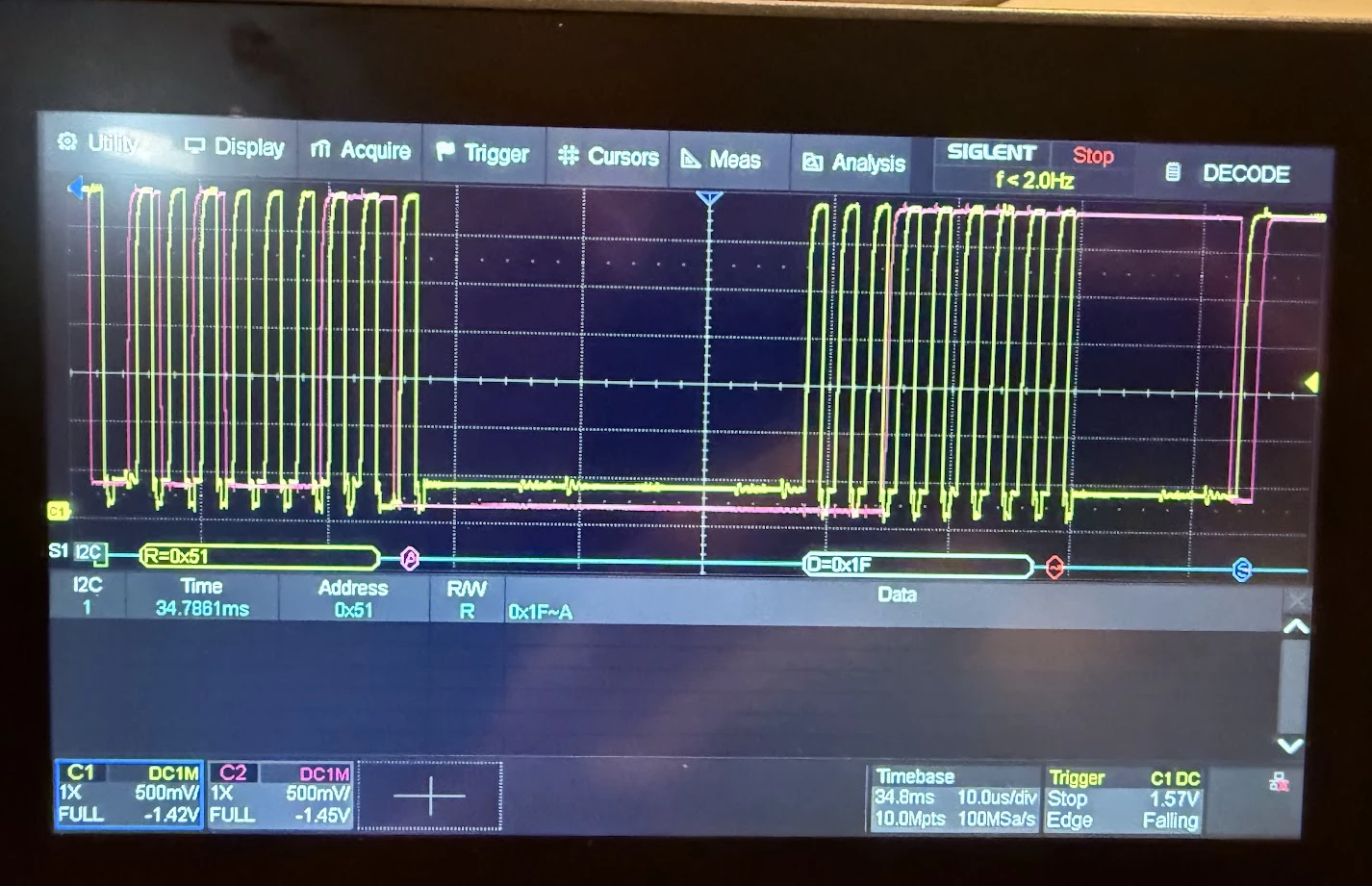

Hello, I'm trying to communicate with a STM32G070CBT6 bootloader, with mixed success. I've forced the chip into bootloader mode by writing a 0xDBFFE1AA to the FLASH option register (by default it was DFFFE1AA). I've verified that this value "stuck", and that the chip is booting up into bootloader mode.
Using AN4221 as a guide, and using the I2C interface, I am able to sucessfully execute the "get version" command, which returns 0x12 (bootload version 1.2).

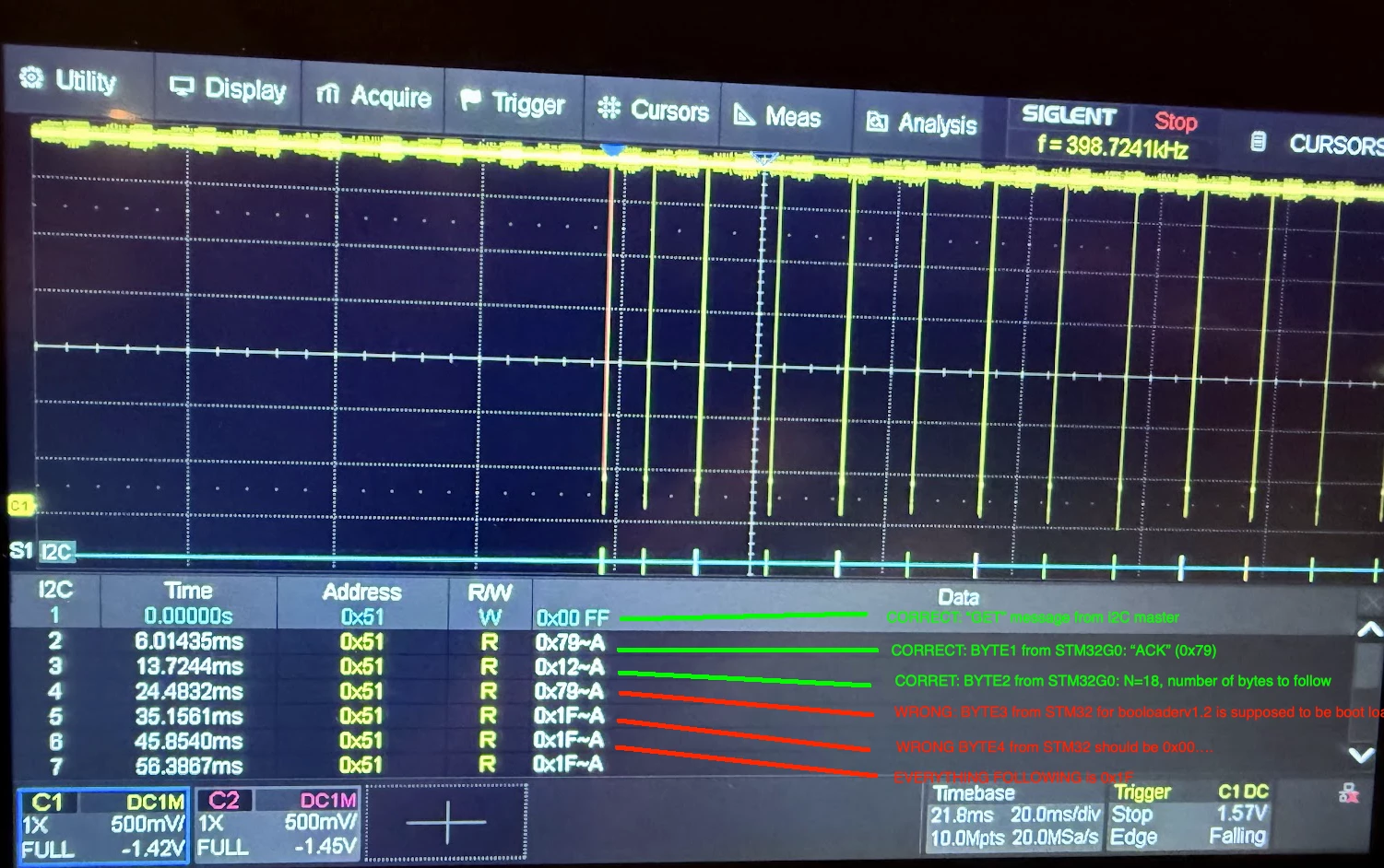

However, all longer commands are failing. Here is a capture and protocol decode (with my annotations) of the "GET" command (command 0), The first 2 bytes of response is corect, however everything following that is 0x1F
Here's a zoom-on of the first 0x1F response:

Ok, I have found the issue: I was reading every response byte as a new frame... If I read the rest of the bytes after byte#1this command works.
#get
i2ctransfer -f -y 2 w2@0x51 0x00 0xff  #write command
i2ctransfer -f -y 2 r1@0x51            #read ACK
i2ctransfer -f -y 2 r20@0x51           #read the rest of the bytes, must be one frame
