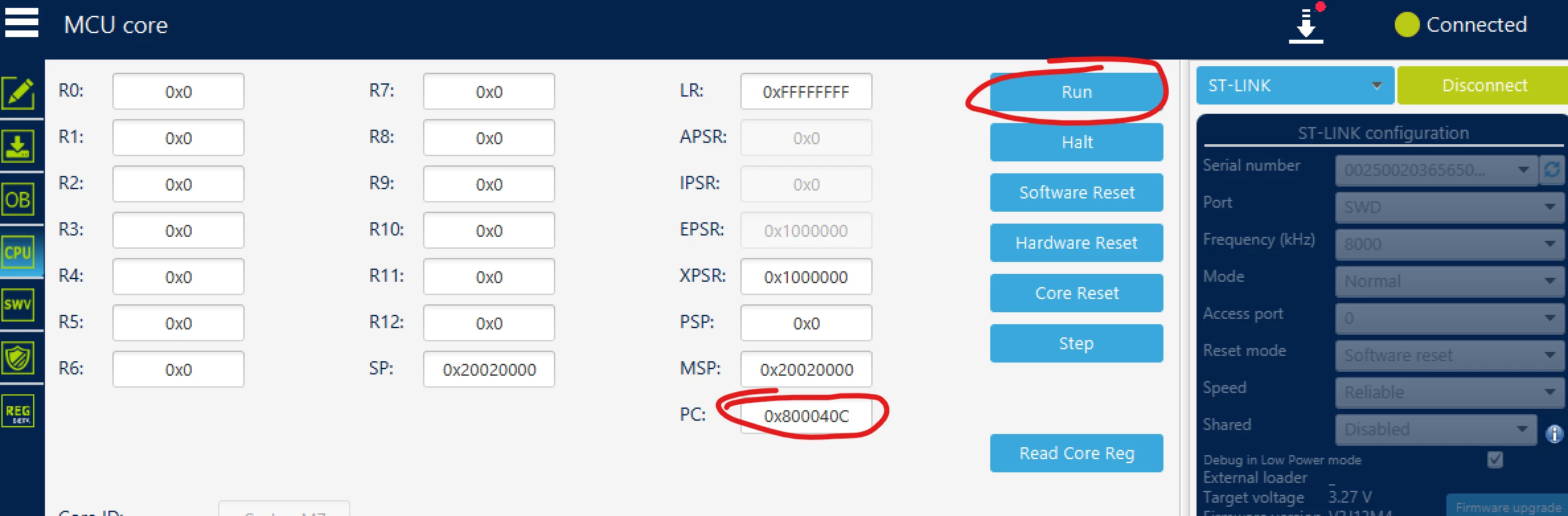

Each person has their own approach to debugging. A very quick sanity check to see what's going on is to connect via SWD using STM32CubeProgammer and use the CPU pane see what the value of PC is. That tells you if you're in the bootloader or user code. If in user-code you can use the CubeIDE Build analyzer to see what function you're in, but then your next step is to start a debug session anyway.

The most likely scenario if most boards work but some do not is there are manufacturing issues. Check resistance of PA6 to ground or VCC. Put it as input with pullup and verify it gets pulled up. Do the same with pulldown. Verify current draw from the device is as expected.
If you don't have source code, you can use STM32CubeProgrammer to run and see where the PC gets stuck, although without the program context this is harder to debug. It should at least convince you that the chip is trying to do something.
