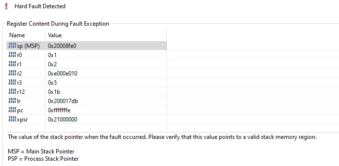

stm32g070 execute code in ram

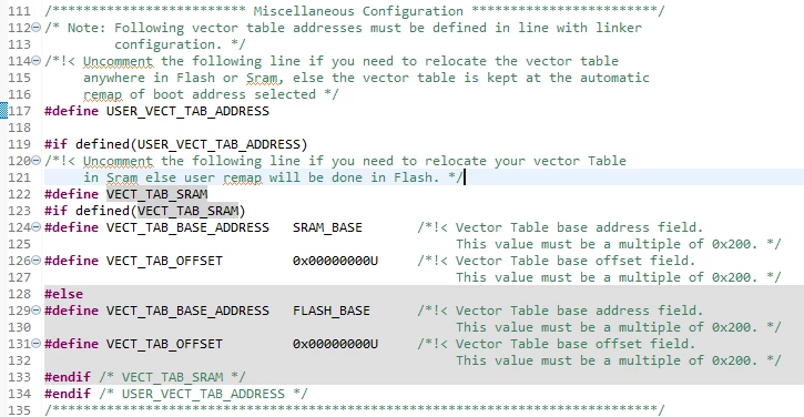

stm32cube mx just generate flash.ld linker script. So I create my own ram.ld linker script, also i modify system_stm32g0xx.c to point the entry point to sram
/* Note: Following vector table addresses must be defined in line with linker
 configuration. */
/*!< Uncomment the following line if you need to relocate the vector table
 anywhere in Flash or Sram, else the vector table is kept at the automatic
 remap of boot address selected */
#define USER_VECT_TAB_ADDRESS
#if defined(USER_VECT_TAB_ADDRESS)
/*!< Uncomment the following line if you need to relocate your vector Table
 in Sram else user remap will be done in Flash. */
#define VECT_TAB_SRAM
#if defined(VECT_TAB_SRAM)
#define VECT_TAB_BASE_ADDRESS SRAM_BASE /*!< Vector Table base address field.
 This value must be a multiple of 0x200. */
#define VECT_TAB_OFFSET 0x00000000U /*!< Vector Table base offset field.
#else
#define VECT_TAB_BASE_ADDRESS FLASH_BASE /*!< Vector Table base address field.
#endif /* VECT_TAB_SRAM */
#endif /* USER_VECT_TAB_ADDRESS */
However, in debug operation, mcu get hard fault interrupt.

Issue solved. I was not using the linker script at the compilation/linking configuration. The code runs perfectly when debugging without modify de boot option byte.​
It is unusual to link an app in RAM because it is volatile, which means its content disappears on a power-cycle.
Ok your linker script puts your vector table, .text, .rodata, .data etc in RAM.
But does your GDB reset after loading your code in RAM?
Check RM0454 section 2.5 about boot modes. If you have not configured your option bytes to boot from internal SRAM (0x20000000), you will need to modify your debug configuration's startup script to ensure your debug session starts execution at your Reset_Handler address in RAM.
Do you actually need to boot from SRAM or is this a learning exercise? Can you share the rationale please?
