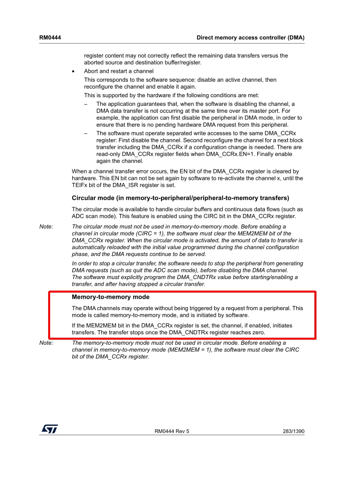

I have read thoroughly RM0454, STM32G070CB datasheet and AN4187 in order to understand how to configure the DMA and DMAMUX in order to feed the CRC peripheral with FLASH data using the DMA (with CPU it is working but way slower than expected).
I don't understand how to start the DMA requests through software, is there anyone who had successfully done it on G0 ?

For those who don't do Cube like me, the answer is that for memory to memory mode and software trigger, the DMAMUX channel related to your DMA channel should be configured as 0,
i.e. for DMA1_Channel1 you should write DMAMUX1_Channel0->CCR = 0;
Then the DMA transactions are started as soon as you enable the DMA channel,
i.e. DMA1_Channel1->CCR |= DMA_CCR_EN;
I divided by 3 the time taken to compute the CRC of 20 480 bytes of flash with the DMA (526us) compared to without.

I tried to reproduce your finding on a 'G0B1 Disco, but was not able to.
In attachment the source. DMAMUX is set to TIM2_UP, and TIM2 is set to overflow once in a second (there's also an ISR to toggle a LED upon TIM2_UP, for visual clue).
If the non-MEM2MEM option is used, observing the dst array in debugger shows, that every second, one more member of that array changes from 0x55 to 0x22 (DMA1_Channel1.CNDTR is decremented accordingly, too).
If the MEM2MEM bit in DMA1_Channel1.CNDTR is set, all members of dst array change to 0x22 immediately, regardless of what is in DMAMUX1_Channel0_CCR.DMAREQ_ID.

Thank you for testing on your side, the RM is correct.
My initial misunderstanding was about the setup of memory (FLASH) to peripheral (CRC) DMA transfer with software trigger.
I was missing the MEM2MEM bit, and since I did not read carefully enough the RM, I was trying to find what DMA_MUX settings would correspond to a software trigger or something related to the CRC peripheral.
My apologies for the confusion and the time you spent on this matter.
