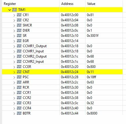

We are having problems getting a PWM output from Timer 1(nothing on the PC10 pin.)
   STM32G070
   Low Level drivers
   Alternate function 2 of PC10 is Timer1 channel 3
   Code is based on STM32CubeG0-master\Projects\NUCLEO-G070RB\Examples_LL\TIM\TIM_PWMOutput_Init
The example in the LL drivers uses timer 6 where we need to use timer 1. Timer 1 has more features so we are guessing that there is another initialization that needs to be done. Here is the code but some of the comments still refer to timer 3. Clock setup first, then Timer 1 init and finally code before the main loop begins. The LL_TIM_EnableAllOutputs() call before the main loop was added from a HAL project that used timer 1.
Any suggestions would be appreciated.

CCER content is incorrect - CC3E bit is not set, so CH3 PWM output is disabled.

Read out and check/post content of TIM and relevant GPIO registers.
Timer1 needs BDTR.MOE bit to be set, but although I don't understand the Cube/LL gobbledygook, it appears that the EnableAllOutput() function might've set that. We'll see that anyway when you post the registers content.

This looks OK. Now check the GPIOC registers.
What hardware is this? You can check is PC10 if properly connected by setting it as GPIO output and toggling in software.​

Modified the TIM_OC_InitStruct to the code below and the PWM is now present. So the LL_TIM_EnableAllOutputs(TIM1) call just before the main loop enables a different output? What is the proper way for starting/stopping the PWM once the control is running?
The comments in the definition of the LL_TIM_OC_InitTypeDef structure state that the uint32_t OCState can be modified later by "This feature can be modified afterwards using unitary functions @ref LL_TIM_CC_EnableChannel() or @ref L_TIM_CC_DisableChannel()"

Indeed. Instead, CC3NP is set, in the "forbidden" combination with CC3P being zero [EDIT] not forbidden for Output [/EDIT]

waclawek.jan
September 6, 2022
If I'm not overlooking something again, this looks good.
Are you sure hardware is OK, there are no bad solder joints, and if this is a Nucleo/Disco or similar, are all solder bridges set as required for this particular pin? Try to set PC10 to GPIO Out and toggle, while observing.
