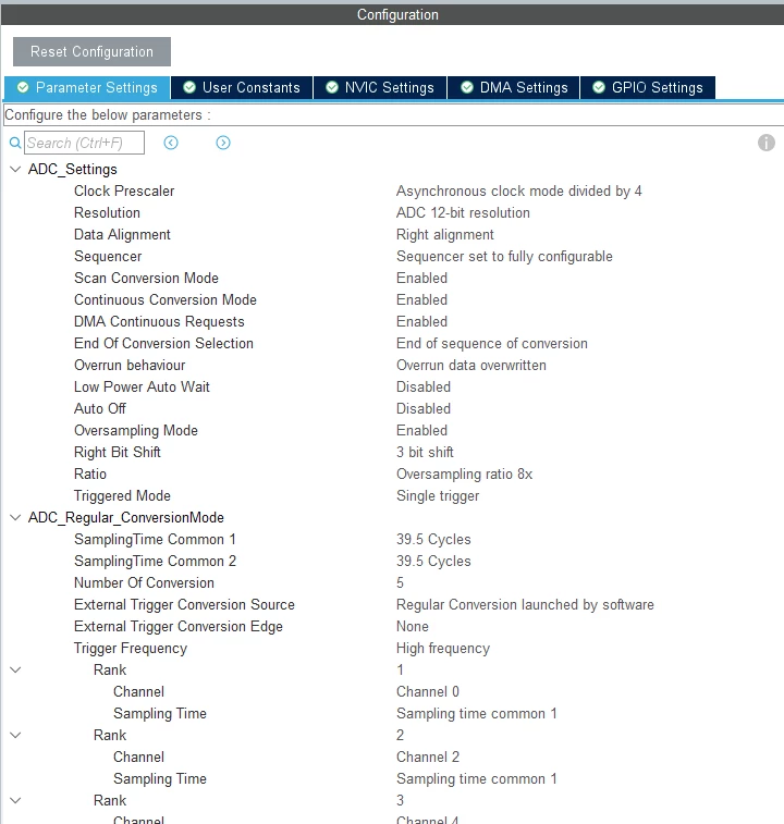

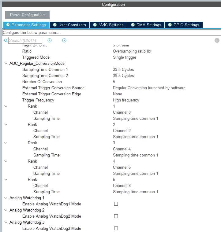

Hi.
I am using STM32G070RB.

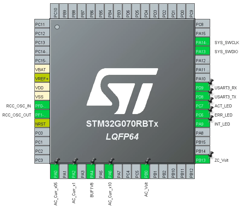

I need to sequentially receive values from 5 channels using ADC DMA.

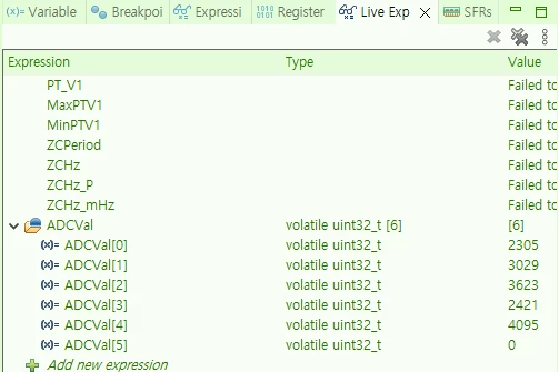

If normal circumstances, the ADC data of PA0 should be stored in Array[0] and the ADC data of PA1 should be stored in Array[1].
However, currently experiencing a bug where PB0's ADC data is stored in Array[0], and PA0's ADC data is stored in Array[1].
PB0's ADC data is a variable value, and the ADC data of other pins is a fixed value.
PB0's ADC data should come out with continuously changing values in the array[4].
Can you give me some advice where i made a mistake?

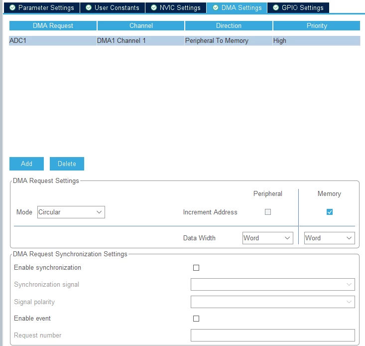

 LL_DMAMUX_SetRequestID(DMAMUX1, LL_DMAMUX_CHANNEL_0, LL_DMAMUX_REQ_ADC1);
 LL_DMA_SetDataTransferDirection(DMA1, LL_DMA_CHANNEL_1, LL_DMA_DIRECTION_PERIPH_TO_MEMORY);
 LL_DMA_SetPeriphAddress(DMA1, LL_DMA_CHANNEL_1, LL_ADC_DMA_GetRegAddr(ADC1, LL_ADC_DMA_REG_REGULAR_DATA));
 LL_DMA_SetMemoryAddress(DMA1, LL_DMA_CHANNEL_1, (uint32_t)ADCVal);
 LL_DMA_SetDataLength(DMA1, LL_DMA_CHANNEL_1, 5);
 LL_DMA_EnableChannel(DMA1, LL_DMA_CHANNEL_1);
 LL_DMA_EnableIT_TC(DMA1, LL_DMA_CHANNEL_1);

Piranha
PiranhaBest answer
Principal III
August 4, 2023
Most likely a problem because of ADC overrun. If it happens, it messes up the channel order. It can happen, for example, because of bus contention, but, while debugging, it basically happens all the time. You have to process it in the ADC interrupt by restarting the ADC channel sequence and DMA at the beginning.

Pierre_Paris
August 4, 2023
Hello @Todg ,
Thank you for your question.
Q : Can you give me some advice where I made a mistake?
A : The mistake probably come from a bad initialization sequence. I downloaded your code and, indeed, I observed the one byte shift in the ADCVal array. (IN0 in Array[1], IN2 in Array[2], ...).
Copy this 2 lines :
 LL_ADC_StartCalibration(ADC1);
 while(LL_ADC_IsCalibrationOnGoing(ADC1));
And insert it between the labels (before the init):
 /* USER CODE BEGIN SysInit */
 /* USER CODE END SysInit */
 Best Regards,
Pierre
