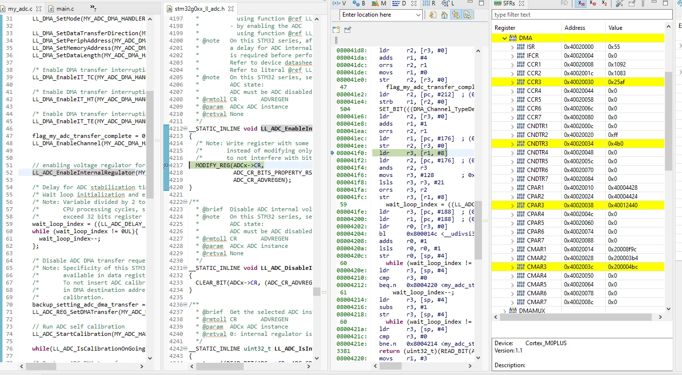

I have a code for stm32g070 which configure the adc as continuous conversion mode, sequencer set to fully configurable, scan conversion mode, dma continuous request, end of sequence conversion, oversampling mode right shift to 5 and ratio 32x.
Also I configure the dma as circular mode with peripheral to memory direction, using an array buffer uint16_t with 1200 halfword size, and enabling half transfer, complete transfer, and error transfer interrupt.
When the conversion start, the half transfer rise, but the buffer is completely full, and after complete transfer end, the buffer is overwritten.
Here the code:
The ADC doesn't wait for your handler to complete before writing more data. If your conversions are fast, it is expected that more than half of the buffer will be populated by the time you get into your HT interrupt. If your code can't keep up with the rate of conversions, the buffer will be overwritten before you can process it.
Consider slowing the conversions down by increasing sampling time, or by using a timer to trigger conversions.

waclawek.jan
November 26, 2021
> I realize that the breakpoint for half transfer callback function is called before enabling adc, how is that possible?
After which point in the code above, exactly?
At that moment (or just before it), read out and check/post ADC, relevant DMAMUX and DMA registers content.

November 27, 2021
There is an explanation for what you're seeing, but I do not think it's in the code that you've presented. Providing a minimal working example that compiles would be helpful.
Or, as JW suggests, providing DMA and ADC registers at the time of the anomaly would shed some light.
I don't know how invested you are in the LL library, but I would ditch it in favor of either direct register access or HAL functions.

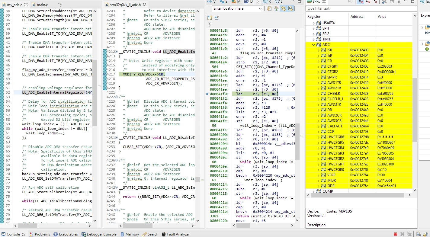

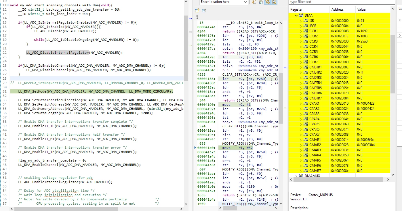

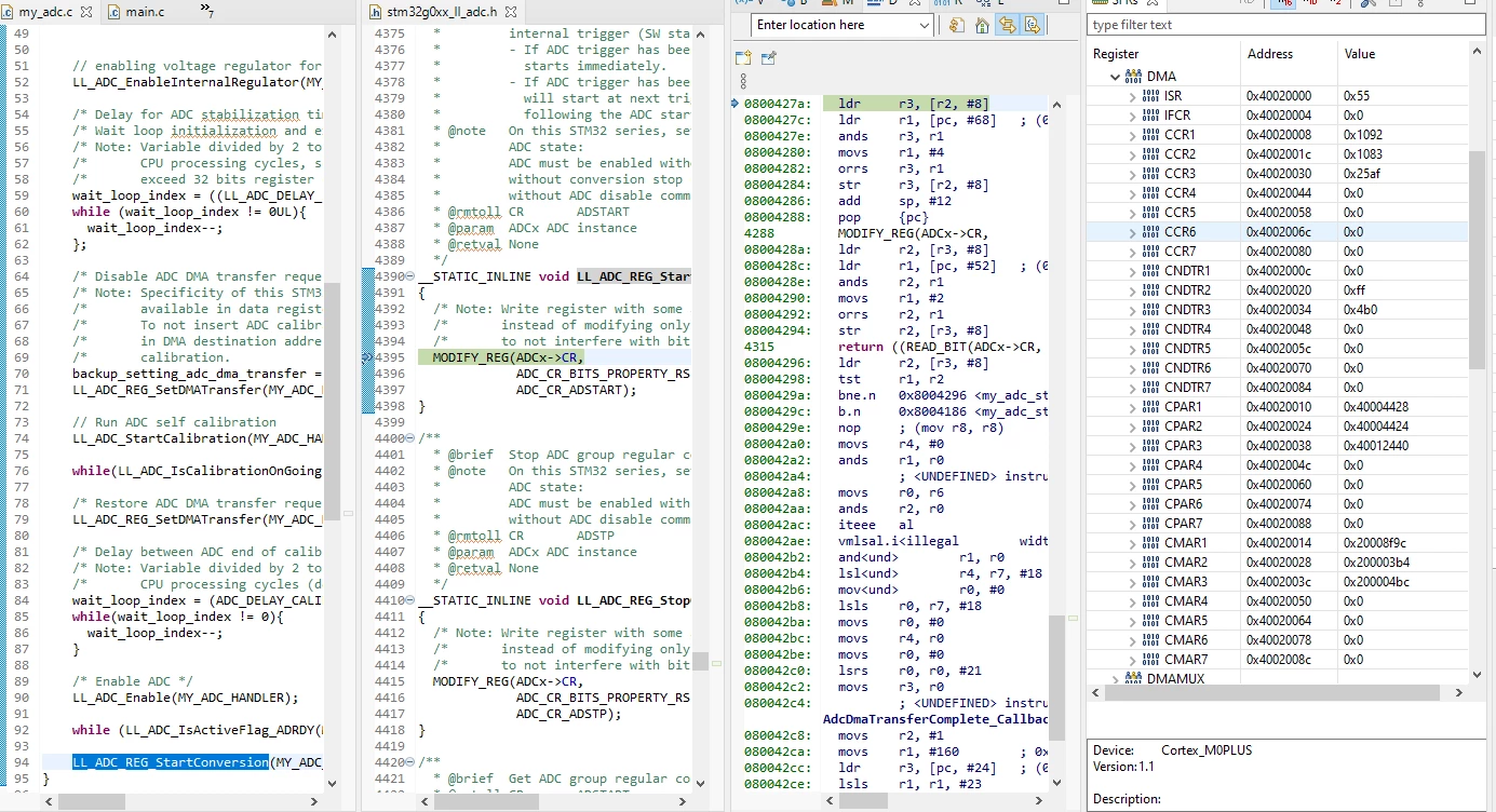

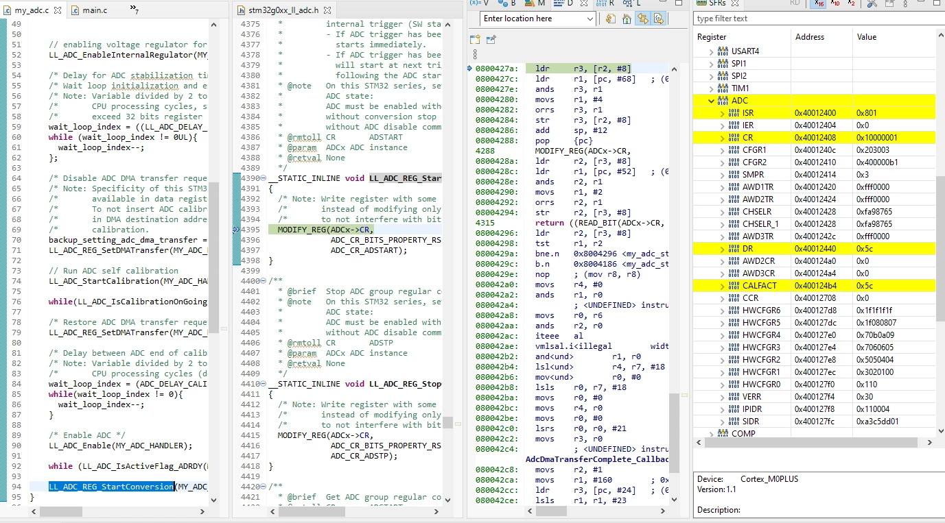

JCuna.1
JCuna.1Author
Senior
November 27, 2021
This is a capture before to configure DMA with buffer.
0693W00000GZ7PlQAL.pngAnd this is before to enabling ADC v regulator.
This is before to calibrate and config ADC
and this is right before to start adc conversion:

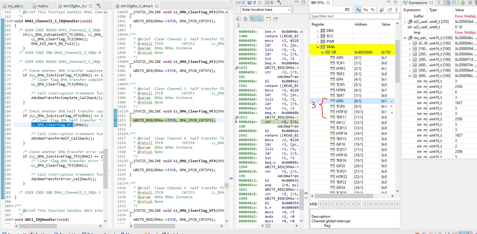

November 27, 2021
> However I am still having the issue with buffer filled completely when half transfer dma flag arise.
Looks like you're using stream 3. But HTIF3 isn't set in any of your screenshots, nor is execution within an interrupt.

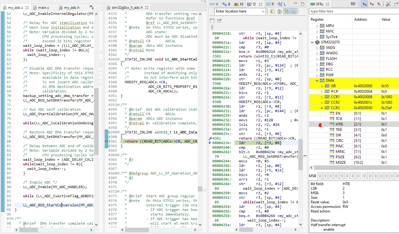

JCuna.1
JCuna.1Author
Senior
November 27, 2021
In these lines I configure dma channel 3 transfer interrupts
/* Enable DMA transfer interruption: transfer complete */
LL_DMA_EnableIT_TC(MY_ADC_DMA_HANDLER, MY_ADC_DMA_CHANNEL);
/* Enable DMA transfer interruption: half transfer */
LL_DMA_EnableIT_HT(MY_ADC_DMA_HANDLER, MY_ADC_DMA_CHANNEL);
/* Enable DMA transfer interruption: transfer error */
LL_DMA_EnableIT_TE(MY_ADC_DMA_HANDLER, MY_ADC_DMA_CHANNEL);
And checking the DMA register it is effectively activated:
HTIF3 is not set because the capture is just related to the register before to start a conversion.
JCuna.1
JCuna.1Author
Senior
November 27, 2021
When the first half transfer interrupt arise I can see that a transfer complete interrupt flag also arise.
waclawek.jan
waclawek.janBest answer
November 28, 2021
When you stop the mcu in debugger, ADC and DMA keep running.
