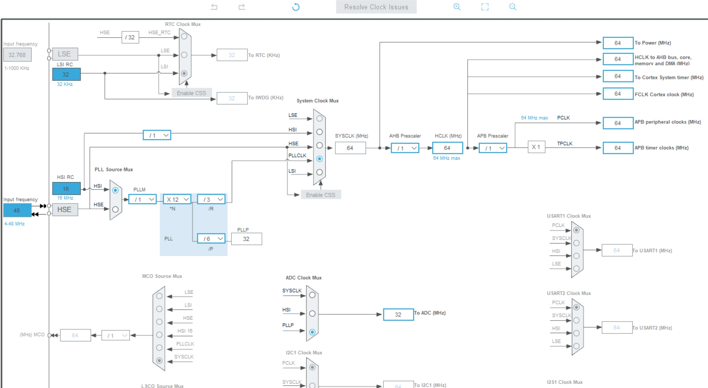

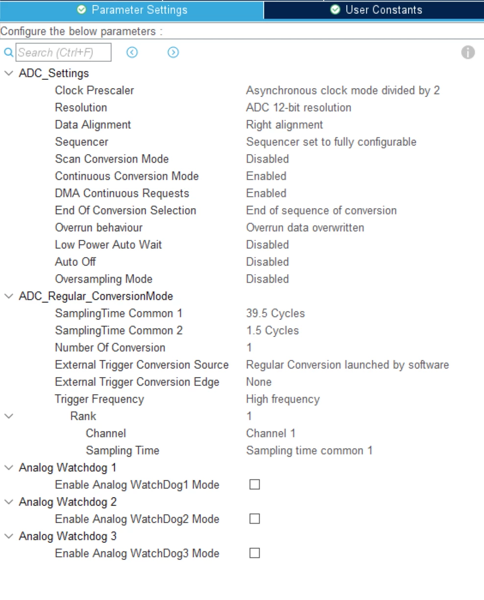

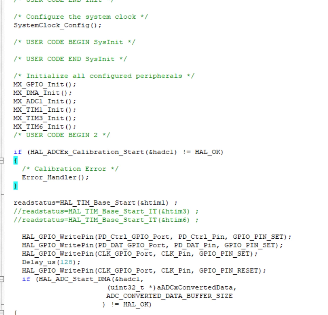

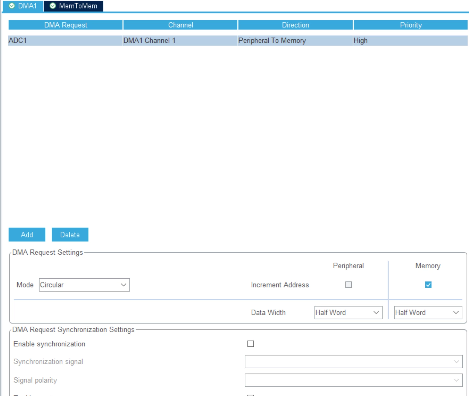

I am using an STM32G070CB. while using the ADC, I found that the accuracy of the data I get is very poor, the data returned is always returned as 0xXXFF, but the data for VREF and GND is correct. I think I must have something wrong with the settings somewhere, but I have changed the modes a lot and I still get data with terrible accuracy.
Please help to see where the settings are wrong.
Thanks.
Here is my setting:
3 replies

Hi @YChen.9 ,
Several tips to optimize ADC accuracy for STM32 products are provided in the application note AN2834: How to optimize the ADC accuracy in the STM32 MCUs.
In case you don't find a way, retry following the step by step article Getting started with ADC - stm32mcu. Check if it works properly with a configuration similar to the one used in this article.
Last point to consider: if you are using a Rev.A device, you may be facing the limitation "ADC offset may be out of specification"  described with more details in the product errata sheet.
Show.
Is it 0xXXFF also in ADC data register?
