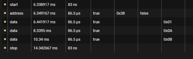

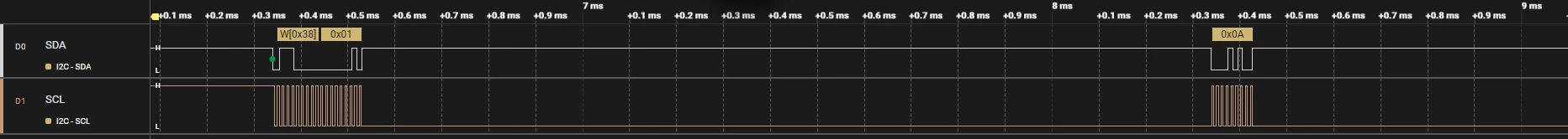

i use a STM32G051K6 with LL Drivers and want to implement I2C. But all the time it sends Slave ID, 0x01, Byte 1, 2 and so on. Here i Call 0x38 Slave ID:
And here all Data:
And this my Code:

I tried like in the link but with nearly the same result. Now it doesn't increment the send data - so i think the loop fills the Buffer more then one time in a for increment but the 0x01 stays the same - even if i decrease the send bytes to 1. Also 10 Bytes begin with a 0x01 after the Slave Write Command.

i am a step into... I Debugged it and have seen that I2C_TXDR holds 0x01 while i start the transmission. But there is also I2C_ISR->TXE set so i can't write TXDR.
Now i flush TXE and then i can write in the Register - everything works now fine.
