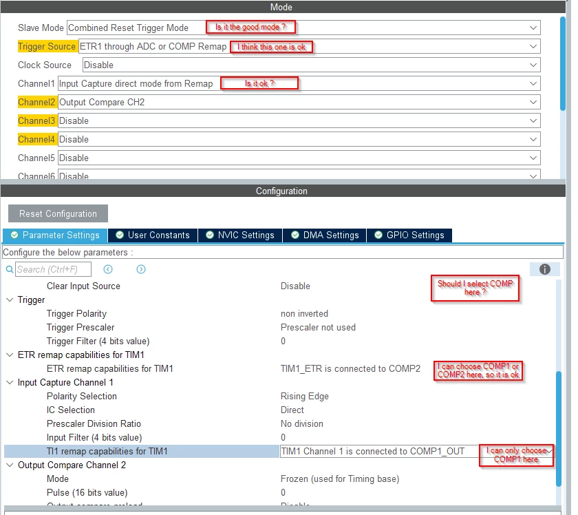

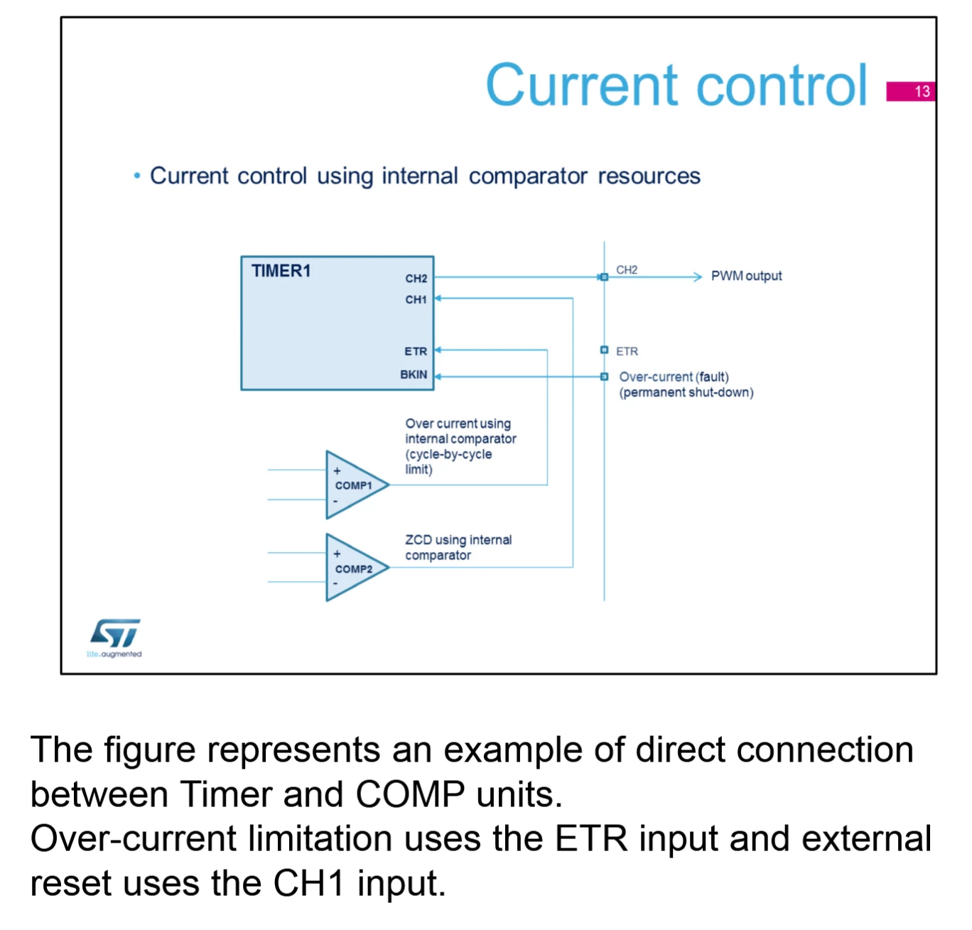

I am new with STM32. We would like to do a current control exactly like on this document :
https://www.st.com/resource/en/product_training/STM32G0-Analog-Comparators-COMP.pdf
page 13
But we would like to use COMP1 for ZCD and COMP2 for overcurrent.
However, it is not clear if it is possible and how to configure the MCU.
Anyone can help ?

I have experience with TMS320F28XXX (Texas Instrument) and PIC (Microchip).
