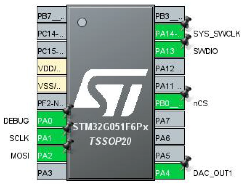

I have a custom board with an STM32G051.  The STM32 is a SPI receive only device.  PA1 is SCLK, PA2 is MOSI, PB0 is nSS (which is hardware controlled).  The beginnings of the project where created with CubeMX so the clocks should all be set correctly.

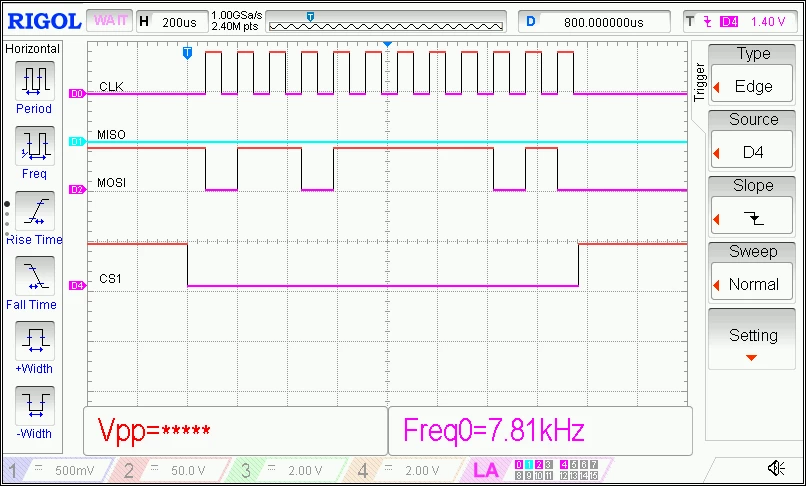

The SPI transactions are simple 12-bit data with an active low chip select.  Note that the MISO signal is not connected on the board.  The master device does not read any data from the STM32G051.

This is really a minimal project as the pin connections below show:
If anyone has suggestions (other than switching to a bit-bang solution) I would be happy to try it.  I have tried using the SSM (software slave management) and the EXTI0 falling edge interrupt but that didn't work either.

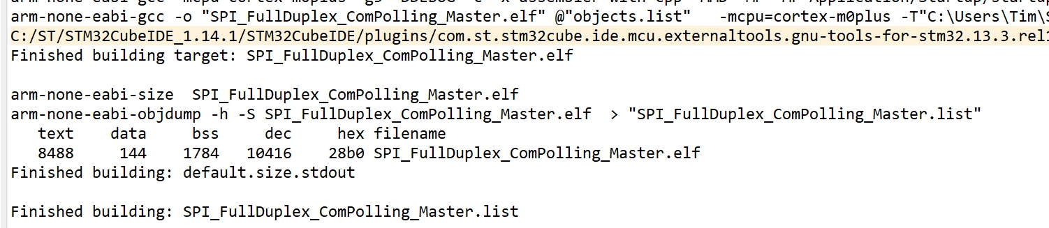

I did try to use the example projects of SPI_FullDuplex_ComPolling_Slave and SPI_FullDuplex_ComPolling_Master.  I was able to get the Master version to run but the Slave version also did not receive any data; however, I did have to make a number of changes to get both versions to compile and run.

I was able to load the SPI_FullDuplex_ComPolling_Master example from STM32CubeMX and compile it without any changes. I'd suggest starting from there and from using the unmodified HAL functions.
How exactly was this determined? Did code time out and return HAL_TIMEOUT? Or was the data not as expected? Were the CLK or NSS signals active?

I originally used the debugger to write (not read) the DR register, although I have since added a debug line of code to do it without the debugger.  The idea was to see if the SPI peripheral was responding to the nSS signal.  Since the TXE status changed I am assuming the SPI peripheral did see the nSS signal.
The RXNE status bit is not going active and I am getting the HAL_TIMEOUT response from the code that is polling the RXNE status bit.
I will try using the standard two-line mode and see if that works better (although clocks will never be sent by the 'G051 since it is slave mode).
