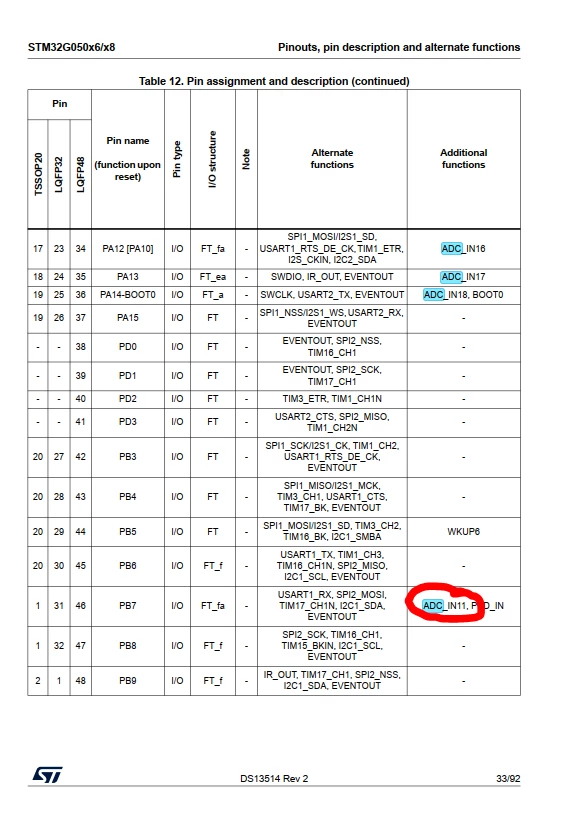

STM32G050C8T6 ADC_IN11: inconsistency in the datasheet?
According to the datasheet PB7 can be used as  ADC_IN11.
Is this an error in datasheet? ADC_IN11 is already used by PB10 and cubeMX doesn't seem to allow me to use PB7 or to remap this pin. How can I use ADC_IN11 on pin PB7 as mentioned in datasheet?
Thanks
Bubbles
BubblesBest answer
April 22, 2024
Hi @AHame,
the DS is unclear as it indicates two possible bondings of the ADC inputs without making the distinction between packages. A decision was made to make the ADC inputs available on smaller packages even if the primary pin dedicated for the function is not available.
So LQFP48 has for example ADC_IN11 bonded to PB10, but as PB10 is not on small packages, the ADC_IN11 is rerouted to PB7 on those. But on LQFP48, ADC_In11 is only on PB10.
I explained the situation to the datasheet responsible and it should be fixed soon.

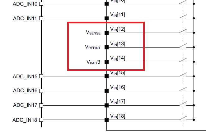

Interesting catch..
Also I don't see ADC_IN14 go anywhere, and ADC_IN15 routes to PA11/PB11/PA9 and ADC_IN16 PA12/PB12/PA10, but some of those may be bond-out related
https://www.st.com/resource/en/datasheet/stm32g050c8.pdf
@mƎALLEm
mƎALLEm
April 9, 2024
Just for your information: ADC_IN12, ADC_IN13 and ADC_IN14 are tied internally to internal sources:
RM0454 rev 5 / Figure 32.:
I also have a doubt regarding ADC_IN16: mapped on PB12 and PA12!
Need to check..
Tesla DeLorean
Guru
April 9, 2024
Yes, didn't get to the RM when I posted. Don't see any reference in the DS.
Perhaps some "note" related to VBAT pin would be appropriate? The DS is frequently used by HW designers to get the lay-of-the-land without getting dragged into the specifics at a SW / register level.

AHame
AHameAuthor
April 9, 2024
Sure, I agree that the source of truth should be the datasheet not cube, but I usually use both the datasheet and Cube just to sanity check during the hardware design.
That being said my question was regarding ADC_IN11 and it is still not clear to me how I'm supposed to use PB7 configured as an ADC input ( ADC_IN11).
Should I assume that PB10 and PB7  are internally connected on the die? That would mean that if I configure the ADC channel 11 using the ADC registers  I could then use both PB7 or PB10 for the input pin? Seems strange to me but that could technically be possible.
