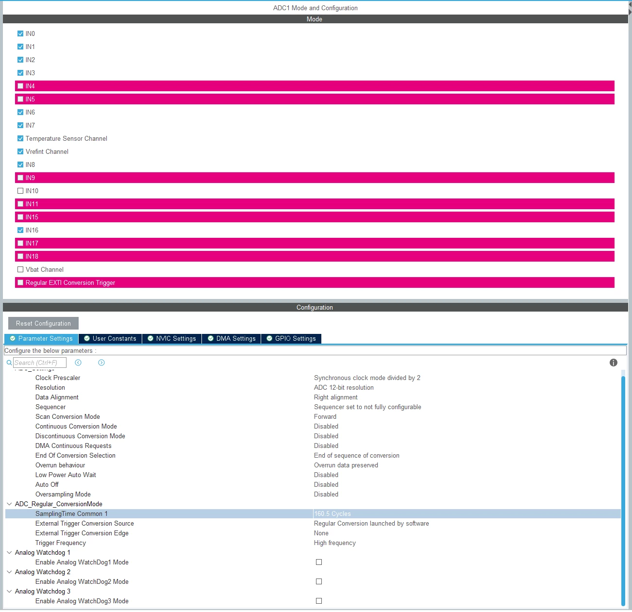

STM32G05 ADC problems adding IN8, IN9 or IN10
Hi.
I'm using an STM32G051 and would like to use 12 ADC channels which are not sequential. I have thus set up the ADC for 'sequencer set to not fully configurable' as show below:
Ignore for the moment that IN9 is red, I think I was trying something with one of the comparators to see if that helped.
I'm using the DMA to kick off a new conversion and the callback reports back raw values which I print out as seen below.
If I enable IN0, IN9 or IN10 then I get bad data from the ADC (possibly mixed up channels) as seen below where the VREF+ is being reoprted as over 5V when it should be 3.3V.

Seeing as I'm not using fully configurable mode, it is my understanding that the rank is the same as the channel number, but I don't see how this should affect the data that I read from the DMA buffer. If I am using 9 channels then my DMA buffer has a length of 9. The index I use into this buffer follows the order in which the channels are added in the MX_ADC1_Init() function. For example:

In that example I use index 7 in the DMA buffer to access the raw VREF value. In the example above this all works ok but if I were for example to use IN8 instead of IN16 (still a total of 9 channels) still using an index of 7 for VREF, then all the numbers are incorrect? Just for completeness, here's the channel configuration for that last example using IN8:
This isn't right. The order is the order of the channel numbers.
If you add CH1, VREFINT and CH8, in any order, they will be converted in the order CH1, CH8, VREFINT, since VREFINT is connected to CH13.
So for you, the order is:
(first example): 1, 2, 3, 6, 7, 8, TEMP(VSENSE, 12), VREFINT(13).
(second example): 1, 2, 3, 6, 7, TEMP(VSENSE, 12), VREFINT(13), 16

Yes I was starting to work that out earlier when I matched up the numbers with the indices, so thanks for confirming.
It's a shame the HAL stuff doesn't add the channels in the channel order because it's not obvious what the channel numbers are for ADC_CHANNEL_TEMPSENSOR and ADC_CHANNEL_VREFINT, even if you hover the mouse over those macros, unless you know where to look, it's not obvious which part is the channel number.
It also doesn't help that you can't rely on the ordering of the channels in CubeMZ which lists the temperature sensor channel after IN7 and the Vrefint Channel after the temperature sensor (i.e. before IN8).
