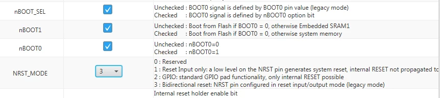

@TDK, the BOOT0 option is not disabled, only NRST_MODE is changed to "2".
I have connected band new (unprogrammed) STM32G031J6 mcu to UART1 (pin 8=USART1_TX; pin 1=USART1_RX) interface (SWD connects fine tho) to try to enter the UART bootloader with no success as well. I think the issue is that chip does not enter bootloader mode, I think the issue is the 8-th pin that shares BOOT0 function with USART1_TX interface on the same pin, there is no way to synchronize the event
(comapred to other chips where BOOT0 has dedicated pin) when to turn off the pull-up (BOOT0=1 condition) to UART1_TX ACK message. I tried to pull-up 8-th pin to 3.3V via 1k resistor and toggle RST pin to ground, Flash Loader Demonstrator still fails to connect. Wonder if this method works at all, sadly those chips are recent and there is no information regarding this situation at all.
Attaching configuration on brand new chip.

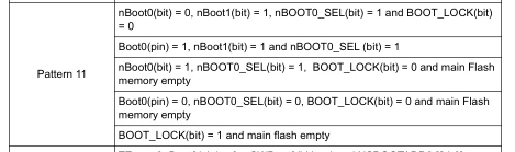

0693W000001tMwpQAE.pngAccording to the datasheet this is the pattern for entering bootloader on STM32G03x devices:
0693W000001tN3lQAE.pngthis is true for my case, all conditions are met, but no result.
