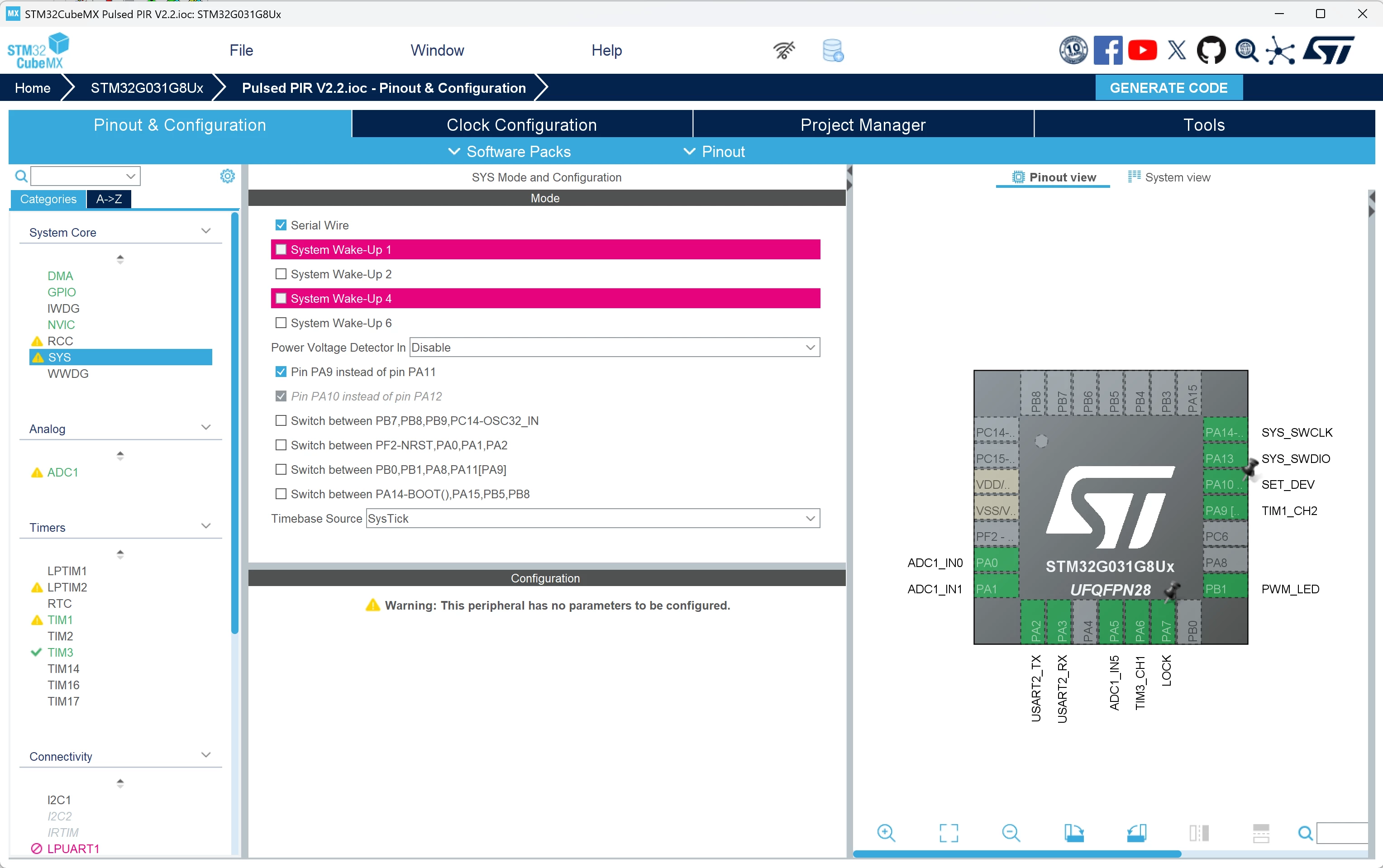

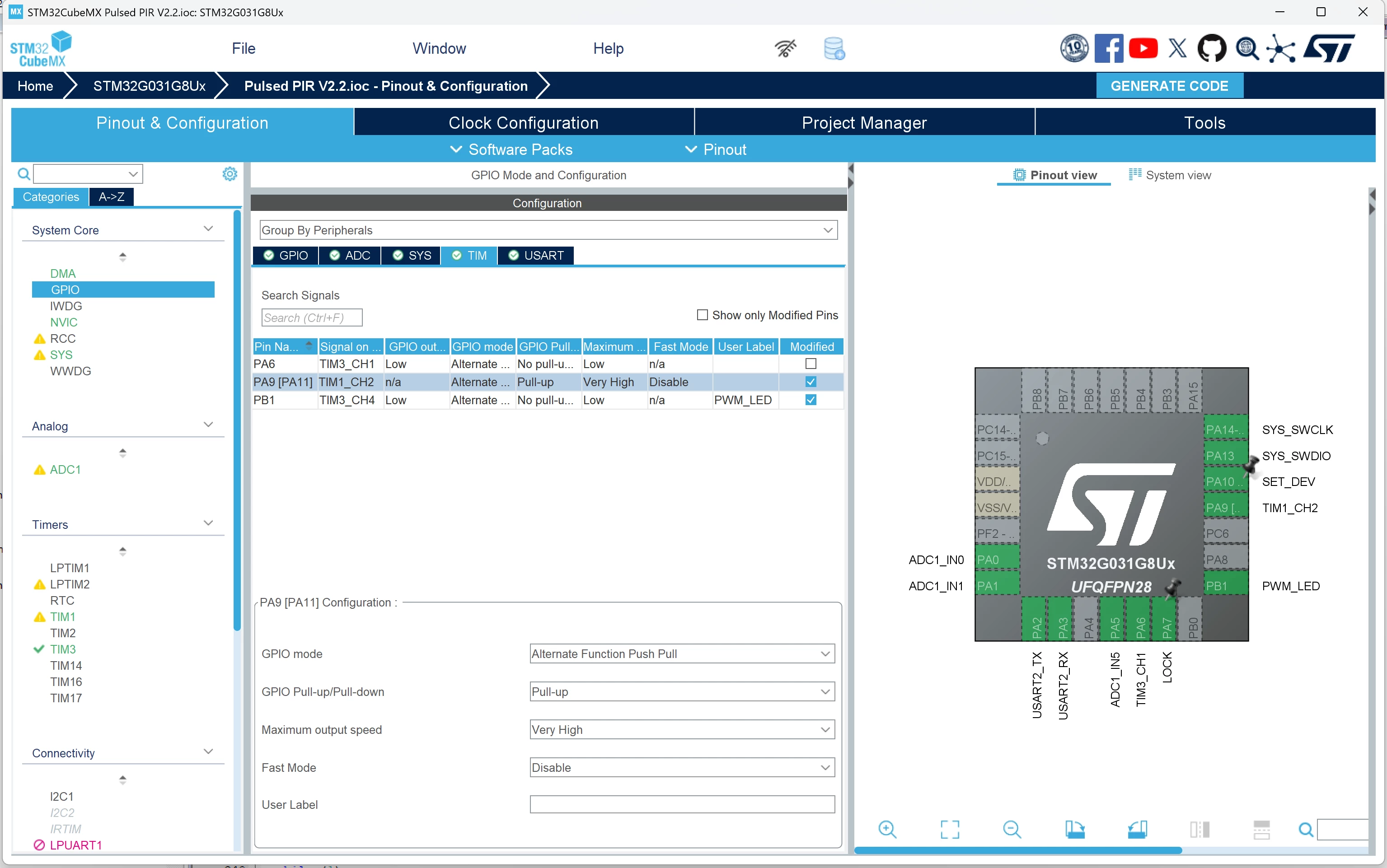

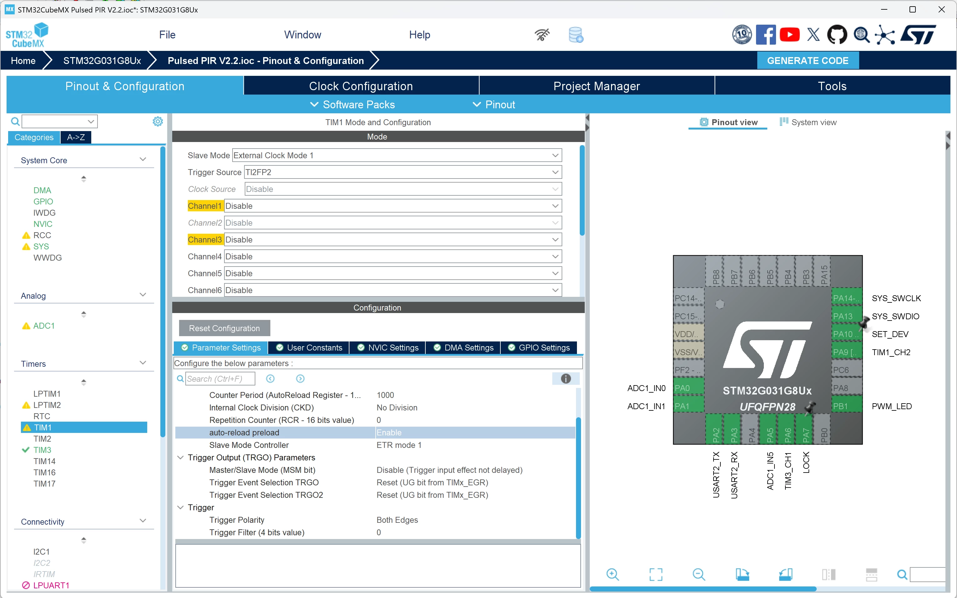

The application is to count a number of rise and fall transitions between 2 timers events; for this reason I have Timer3 configure as PWM output, and I use 2 channels (2 and 3) to set the window where I need to count. Timer 3 generates interrupts and Timer 1 is used as transitions counter; PA11 is mapped as PA9 and the timer use CH2 (TI2FP2) to trigger the counter.
I initialize both timers 1 and 3 and then I start them with:
HAL_TIM_PWM_Start_IT(&htim3, TIM_CHANNEL_2);
HAL_TIM_PWM_Start_IT(&htim3, TIM_CHANNEL_3); and
HAL_TIM_Base_Start(&htim1);
