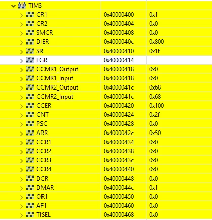

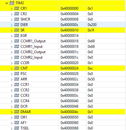

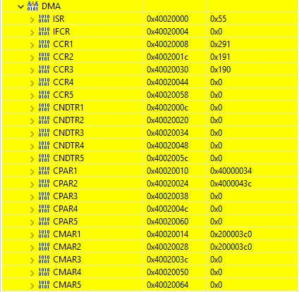

The SFRs for DMA, TIM2 and TIM3 are shown below.

Registers look OK to me.
Can't the problem be in how DMAMUX is configured?

I took a look at the DMAMUX, and ruled it out by writing a loop that updated the CCR1 register when the channel 1 flag was set in the SR. The result is the same.

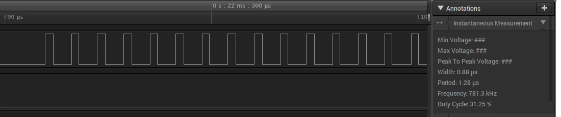

In the end, we have removed the TIM2CH1 code and used TIM3CH3 and TIM3CH2. TIM3CH2 is on pin8 of the device, which is why we avoided it originally, as it is assigned to SWCLK (luckily, we can work with testing most elements on TIM3CH3 only, leaving the part to run on TIM3CH2 also when it is off the debugger). On this channel, we are using DMA Ch1, and it generates the waveform below.
