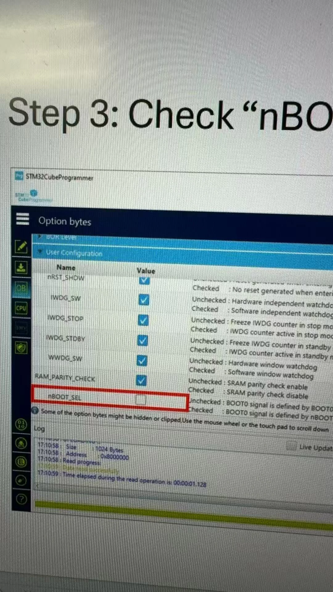

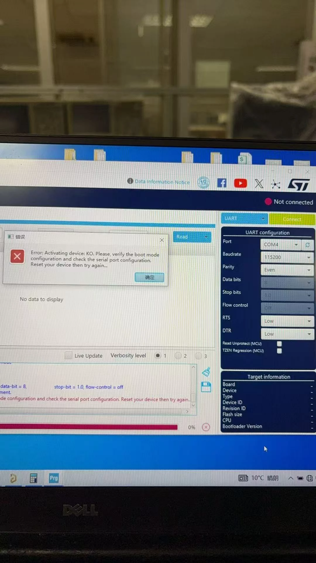

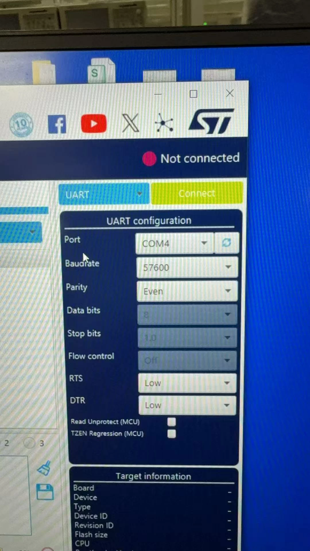

STM32G031Y8Y6TR is now burning some problems would like to consult
Serial port 1 after burning OK, when burning again can not read the MCU situation, help to see what will be the reason, how to solve, thanks a lot.

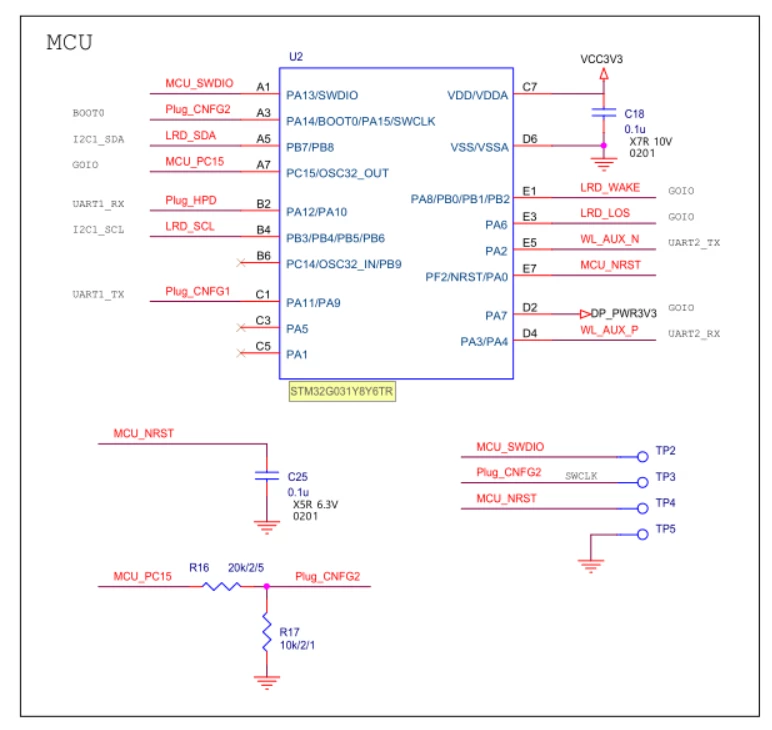

Are you holding BOOT0 high during reset so it enters the bootloader?
Is ground connected between board and UART module?
PingleiAuthor
February 17, 2025
There is ground between the board and the UART module, and the BOOT0 remains at a high level of 5V

5V ??
