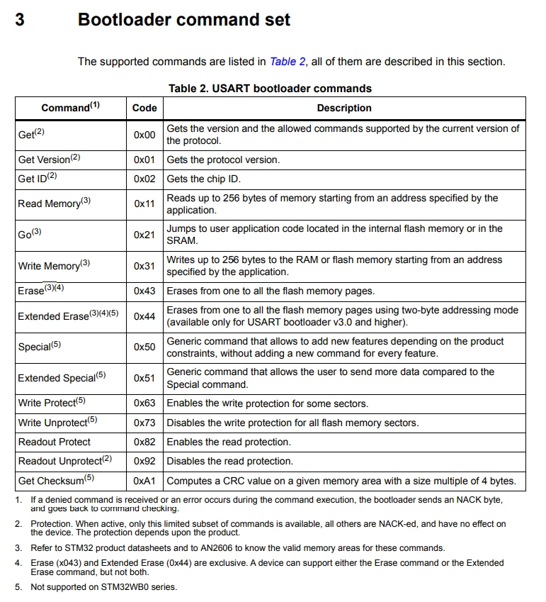

Hi @STTwo-32  ,
I have one more issue. I configured boot pins to enter bootloader at startup of system, but now how do I check if the chip is actually in bootlaoder mode?
I know that the main application code on flash memory is not loaded at start up (mcu not responding to uart comamdns as it does in application code), but when I try to use commands from AN3155:
I get no response on uart (trying "Get version" and "Get ID" commands). The system is connected by STM32G03 connected to FT234XD-T(chip on PCB) and then via USB to PC. The UART communication work without problem in applciation code mode, at 115200 baud.
