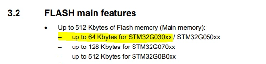

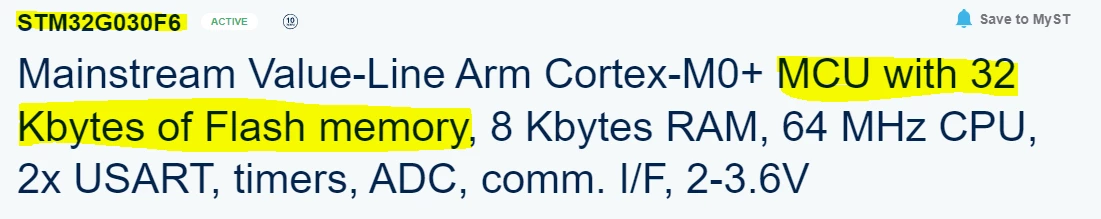

1- What is the flash memory size of my microcontroller? I consulted the datasheet of device and I read:
So, for this series, I can have up to 64 Kbytes of memory flash. Specifically, for this package I should have a 32 Kbytes memory flash. Right?

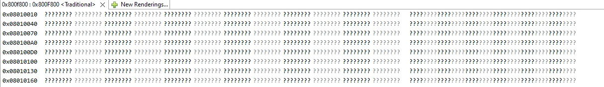

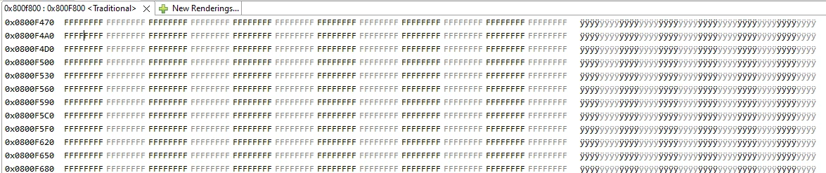

With 'Memory' tool I saw every sector of the flash and where the memory address is out of range, it shows me a series of '?' like follow:
but, where I thinked to be out of range I see that:
Is that unsed flash memory space or what?

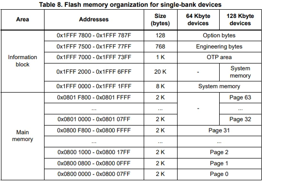

From the datasheet I see the memory organization:  For the main memory there is 2k for each page, so in my case I should have only 16 available pages (?).

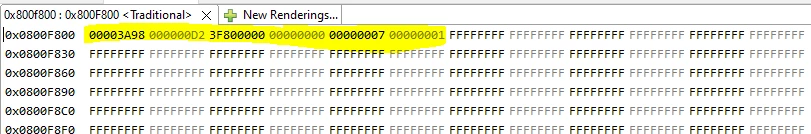

Ignoring that, I started to store my data at page 31 with address 0x0801 0000 and the program seems to work :dizzy_face:
Here's my stored data:
using the following function:
#define FLASH_PAGE_TO_ERASE 31
#define FLASH_DATA_ADDRESS (0x0800F800) //page 31 address

What does it mean? I can't figure it out.

ST uses the same die for multiple chips, but only tests the portion of FLASH guaranteed by the datasheet. In your case, that's 32kB starting at 0x08000000.
There may be FLASH beyond that, which probably works, but wasn't tested and isn't guaranteed to work. Up to you if you want to use it or not.
