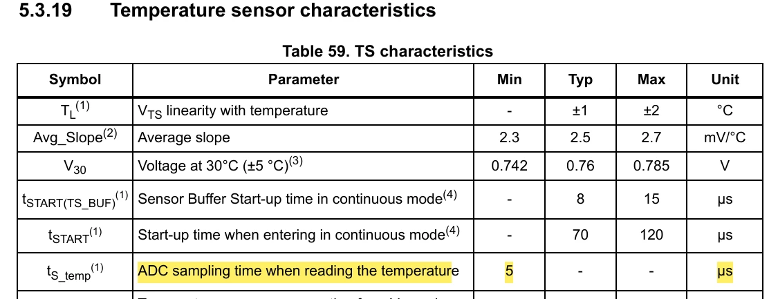

I’m trying to use ADC oversampling and noticed that temperature value is distorted in that case.
I have configured ADC with 7 external inputs, temperature sensor input and Vref input. Vcc/Vcca is 3.27V, sampling time is 7.5 cycles.
When oversampling is disabled - I’ve got averaged raw value 2115 for analog input (voltage 1.64V), 1005 for temperature sensor and 1582 for Vref. When oversampling is enabled (no matter 2x or 16x, with shifting to same count of bits as added by oversampling) - I’ve got 2115 for analog input, 1107 (!!) for temperature sensor and 1584 for Vref. So, only temperature sensor input value differs. And, as result, I’ve got 63*C instead of 33*C when oversampling is enabled.
What’s wrong with oversampling? Can it be fixed by some kind of settings? Or I must forget about it and use software oversampling instead?
I’m using latest CubeIDE 2.2.0 and CubeMX 6.18.1 with latest libs 1.6.3.

There is a minimum sampling time requirement for the temperature sensor. Increase yours to meet this. How much you need to increase depends on what your ADC clock is.
I’ve increased sampling time up to 160 cycles at tests. Nothing is changed.
Number of cycles is not the important criterium.
What is the resulting sample time ?

As ozone said
the important is sample time rate
for example, the STM32G030 max frequency is 64MHZ if it’s all going to ADC clock
if you are using that and 160 cycles your sampling time is just 2.5us which is less than 5us
can you provide at least caption from your clock ocnfiguration?

Yes, but ADC clock rate is up to 35 MHz.
As I replied earlier, I’ve re-checked again with 32 MHz ADC clock and 160 samples and now it works OK, I don’t know why it wasn’t worked earlier I tested it.
