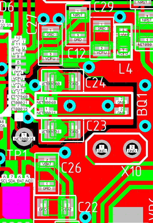

I tried to use internal RTC with LSE clocking in device which has GSM/GPRS module (GSM part decoupled from MCU part by ferrite beads in power lines and resistors in data lines). In first PCB revision (no separate ground region under crystal) I noticed significant RTC slowdown at GPRS transactions (0.2-0.4 seconds at each GPRS data transaction, when I soldered wires to GSM part ground and VCC pads - clock slowdown is increased). I've fixed board layout according to design recommendations (separate ground regions, ground traces around quarts lines, extra ferrite bead in CPU power line) but it doesn't affect clock instability at all.
Vcc is decoupled to ground after ferrite bead by 22pF and 100nF capacitors, before ferrite bead there's a 100uF tantalum capacitor after LDO. Vbat is decoupled by 100nF capacitor and 2x22pF capacitors (there are places for different external RTC modules). Quartz is one with 12.5pF load, load capacitors are 22pF each (I experimented with smaller values - nothing was changed). Driving strength is set to high. PC13 is set as output, low level.
Here's piece of board with quartz, power and Vbat lines. X10 is place for ground shield (shielding doesn't change anything on earlier board prototype).
What's wrong with it? Is there any option to make it stable in high-EMI environment? when I've tested older board revision, there was clock slowdown even when device's GSM module was switched off but there was a second such device with GSM placed in 10-20cm near it.

From that picture I don't quite understand what exactly is the return path from capacitors to mcu ground pin.
Is there any other ground layer around to which those vias are connected?

there's a bottom (green) layer with separate ground region connected to main ground at via near ground pin.

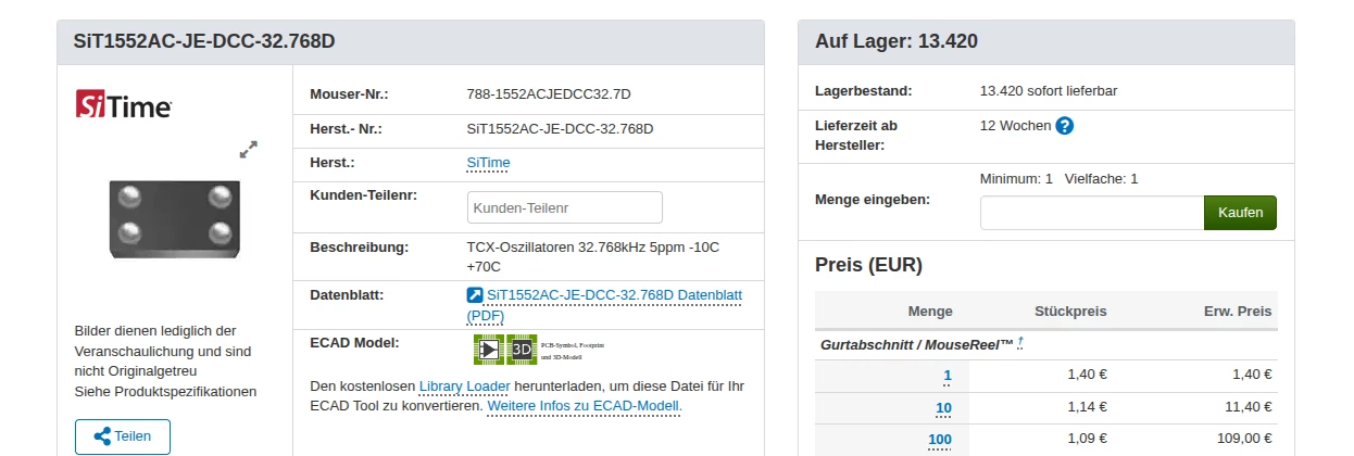

Maybe do it  "my way" : dont use a crystal, use a oscillator;
today about same price as a good crystal + caps.
something like this:
...then check, if there still any influence from ext. radiation .

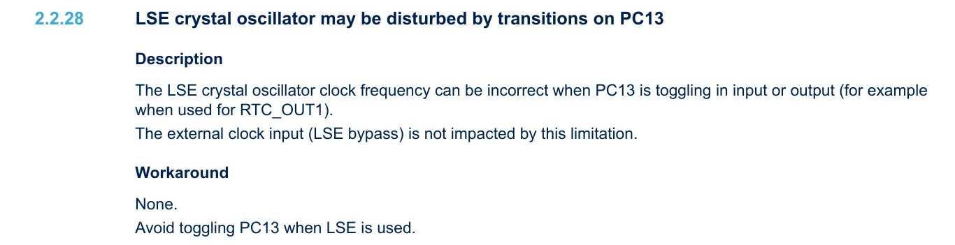

other "problem" with LSE internal osc. : if switching action on adjacent pins...
- so check, if you have any switching on pins next to LSE - pins .
oscillator costs same price as cheap RTCs with oscillator like RX8130CE, and consumes more power than RTC (there is backup 0.22uF supercapacitor for RTC, and oscillator may consume too much extra power).

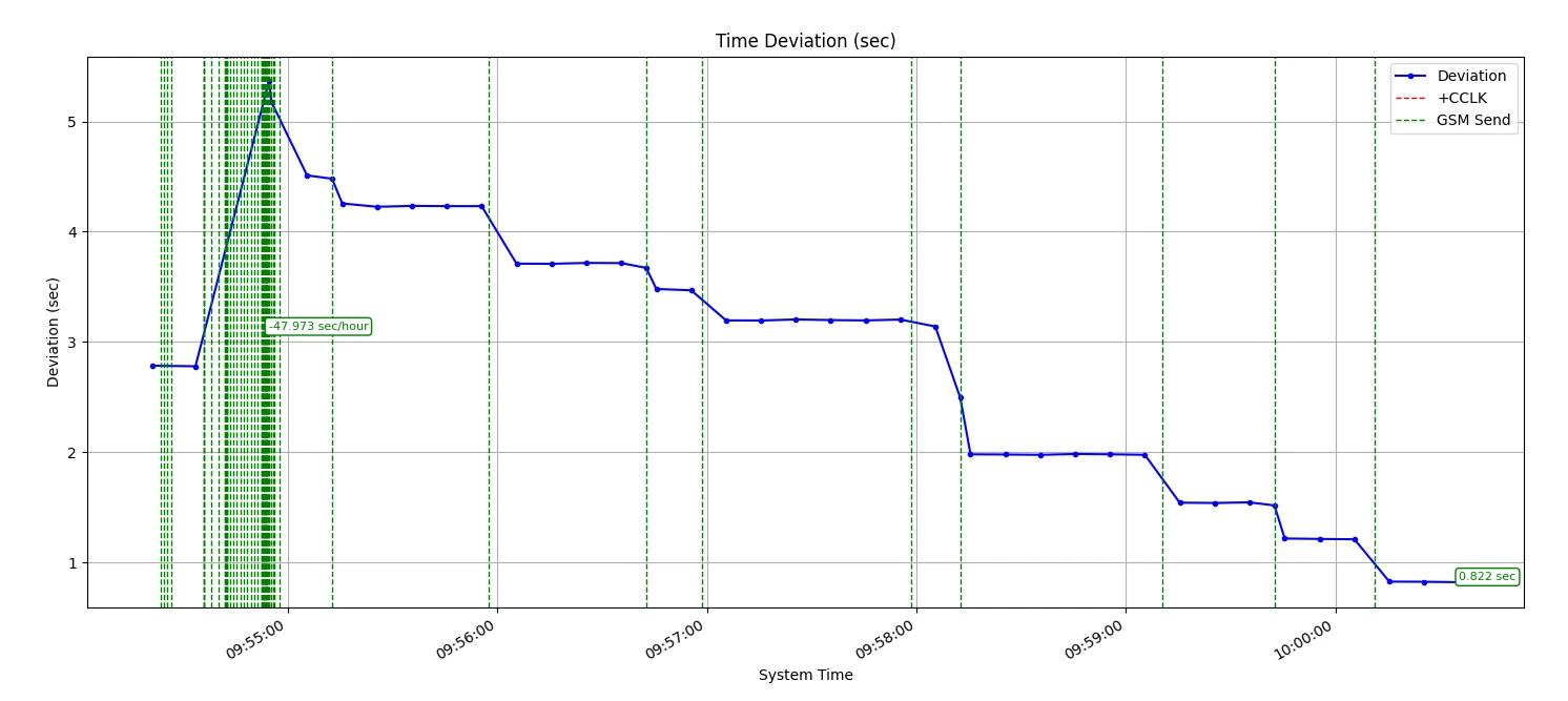

I noticed it in status packets with minute of day reported - clock losts ~5 minutes per 8 hours. Then I've added time logging each 10 seconds to UART, and draw chart with clock deviation on host - and it's flat till next GSM transaction.
Also I placed precise frequency meter at PC13 and enabled test clock output (512Hz) - at normal state it shows 512.034Hz, but during GSM transaction it shows lower floating frequency (4xx Hz).

Here's example chart. dots - clock deviation compared to PC system clock; green lines - interaction with GSM module (AT commands and GPRS data transmission), red line (among bunch of green lines) - initial clock sync.
