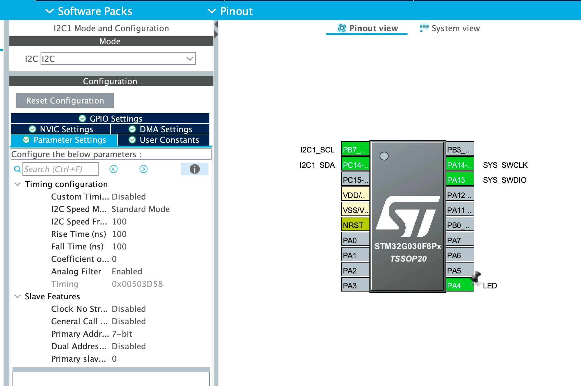

Have an issue with connection I2C sensor to STM32G030 chip.
Function HAL_I2C_IsDeviceReady alvais return HAL_ERROR.
Looks like this controller are not support I2C master, but documentation said:
Features of the I2C peripheral:
I2C-bus specification and user manual rev. 5 compatibility:
Slave and master modes, multimaster capability

BigdanAuthor
September 21, 2024
Add configuration screen of STM32G030.
Have a two boards with this chip and for both I2c are not worked.

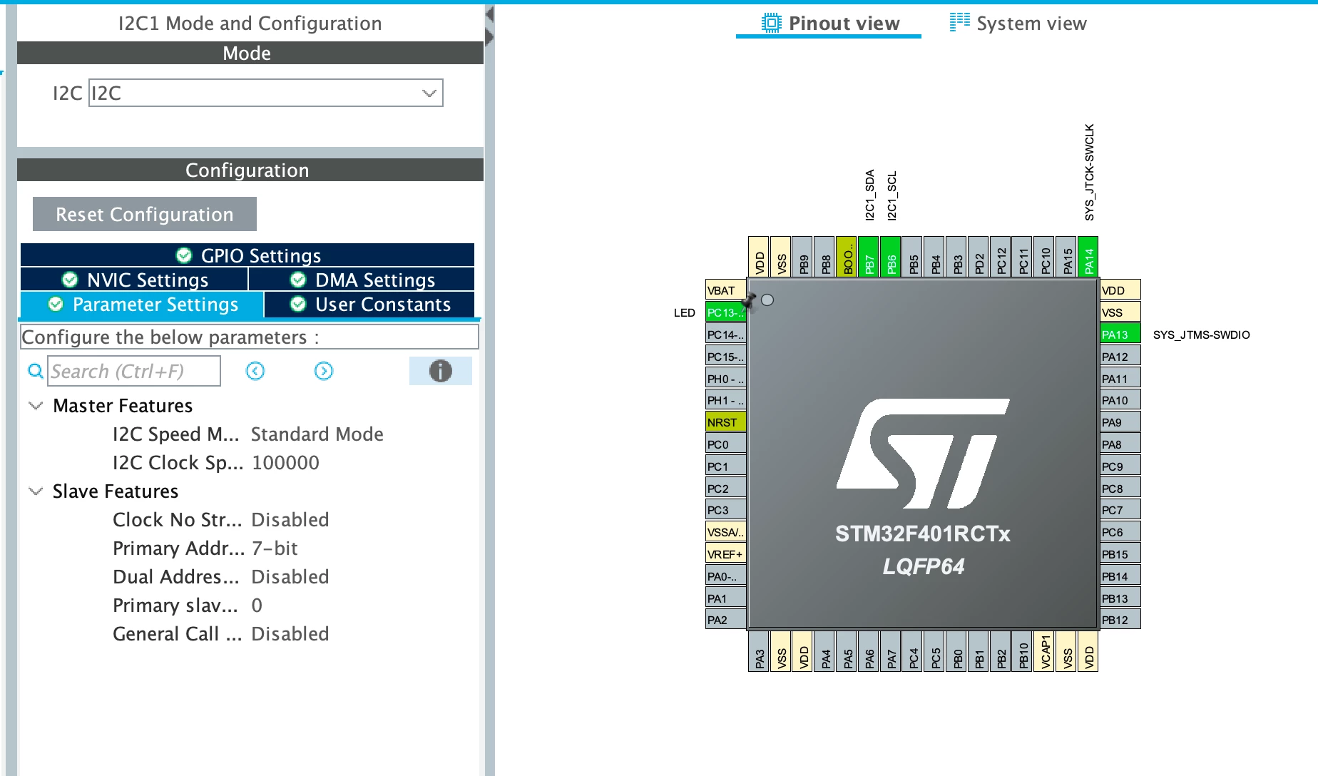

Also add config of STM32F401. Where i2c works. There MASTER section present. In STM32G030 no MASTER section.
September 22, 2024
The peripheral is different and so the configuration screen is different. But it can be an I2C master. Perhaps share your code. What does HAL_I2C_IsDeviceReady return?
BigdanAuthor
September 22, 2024
Found the issue. First one SDA pin was interrupted by jumper. Main purpose of this pin use for external oscillator, Second one, device address specified  by manufacture need shift to one bit (((.
