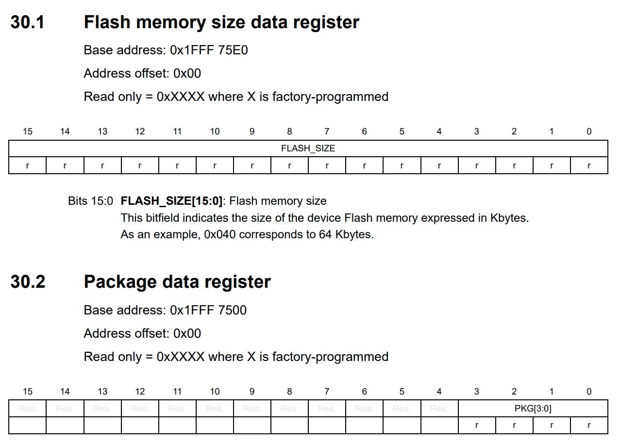

STM32G030,Engineering bytes in RM0454 Rev 4,P43,How to use it?

You read it like any other memory location. Only certain places within this region are specified.
uint32_t PKG = *((uint32_t *) (0x1FFF7500UL)) & 0xF;
