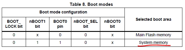

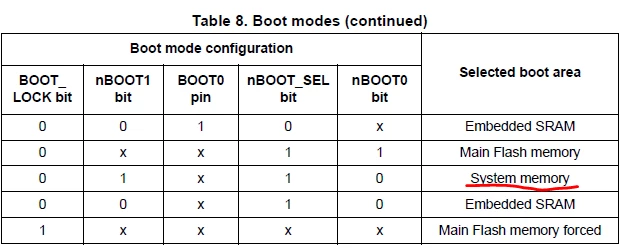

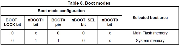

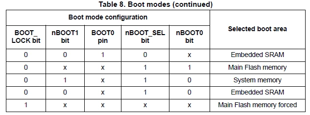

I shared with you all the combinations to select the boot area. Let me share again the table.
To start the MCU from the bootloader or "System memory" you have to use one of these configurations. Once in the bootloader, you will be able to use I2C to program the main flash memory. Once programed to start form the flash you have to change again the option bytes.

AimeBest answer
Sep 13, 2023 9:15 AM UTC
Hi @FrankNatoli ,
