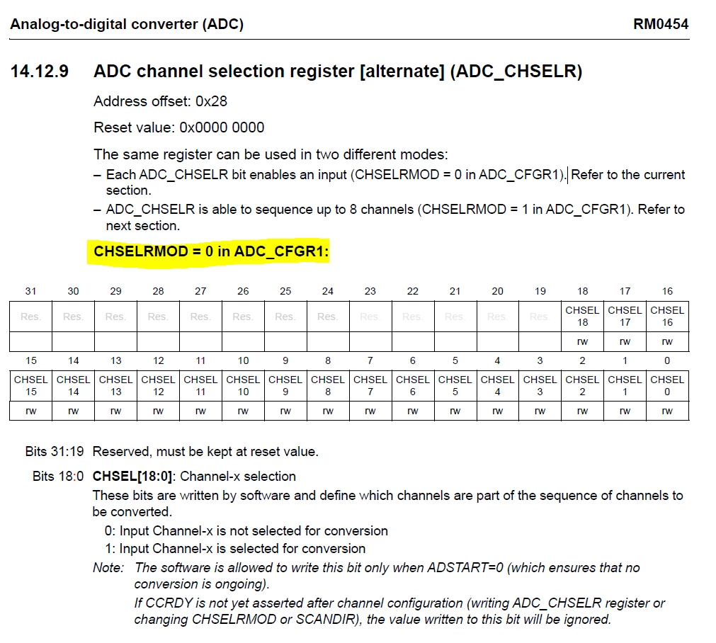

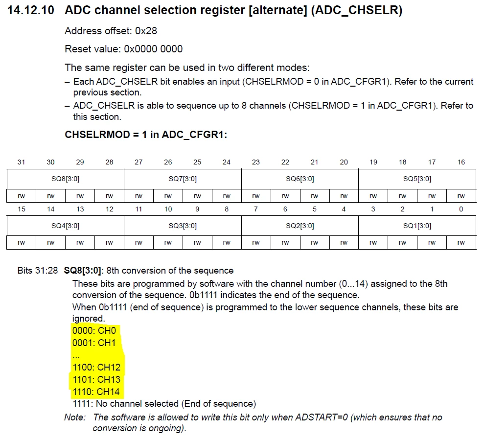

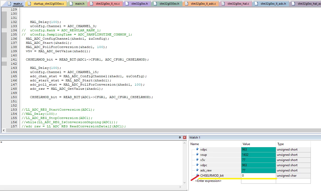

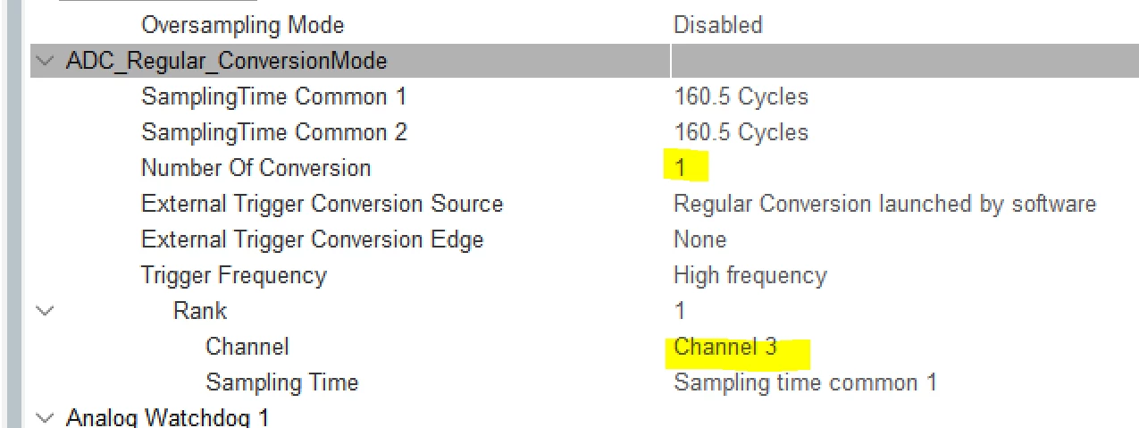

I am using STM32G030C8 microcontroller's several ADCs. Most of them are working okay but two of them (ADC1 IN15, PB11 and ADC1 IN16, PB12) are not showing correct ADC values.
In ADC IN15: When I use only this channel in the code then it shows 0 but when I read multiple channels it shows the value of the channel which is read before it.
In ADC IN16: The value is always very low regarding the actual voltage on that pin.
My VREF is 2.5V. I generated the code with CubeMX and using Keil IDE.
I have tested it in more than 1 hardware with same results. Also I have technically verified the voltage at the pin. The voltage at said pin is varied from 1.2V to 1.5V. Same type of input signals are applied to ADC channels 7,8,9,10,11 and reading values without any issues.
