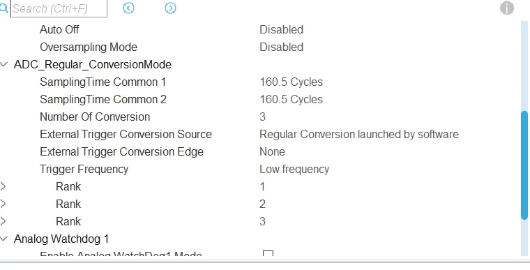

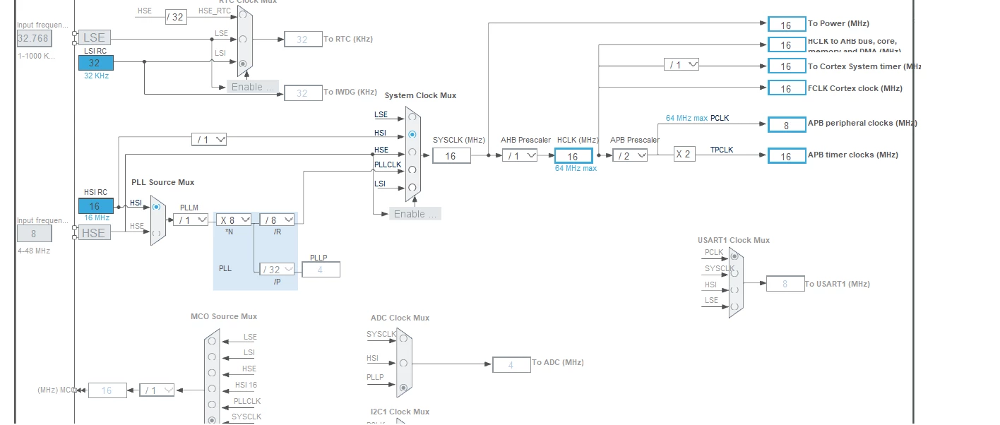

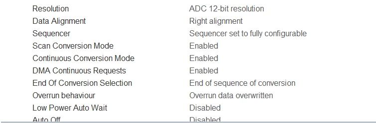

So, i disabled the DMA interrupt and reduced the adc sample rate to  +-6khz, but it is still showing the same behavior, Systick is incrementing too fast when DMA is initialized. here are my ADC module and clock configs.
